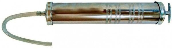

Look for something like this at your nearby NAPA Auto Parts store...
Just be sure to clean it before using it to refill the differential with new oil... or basting a turkey?
Good luck... GUSTO
Good luck... GUSTO
That's the tool you want. I got mine from Amazon for $15- or so. Buy two, as turkey juice is not an approved differential fluid. If your wife cooks whale, however, you can use the renderings as positraction additive, otherwise buy the correct additive when you change the fluid.
