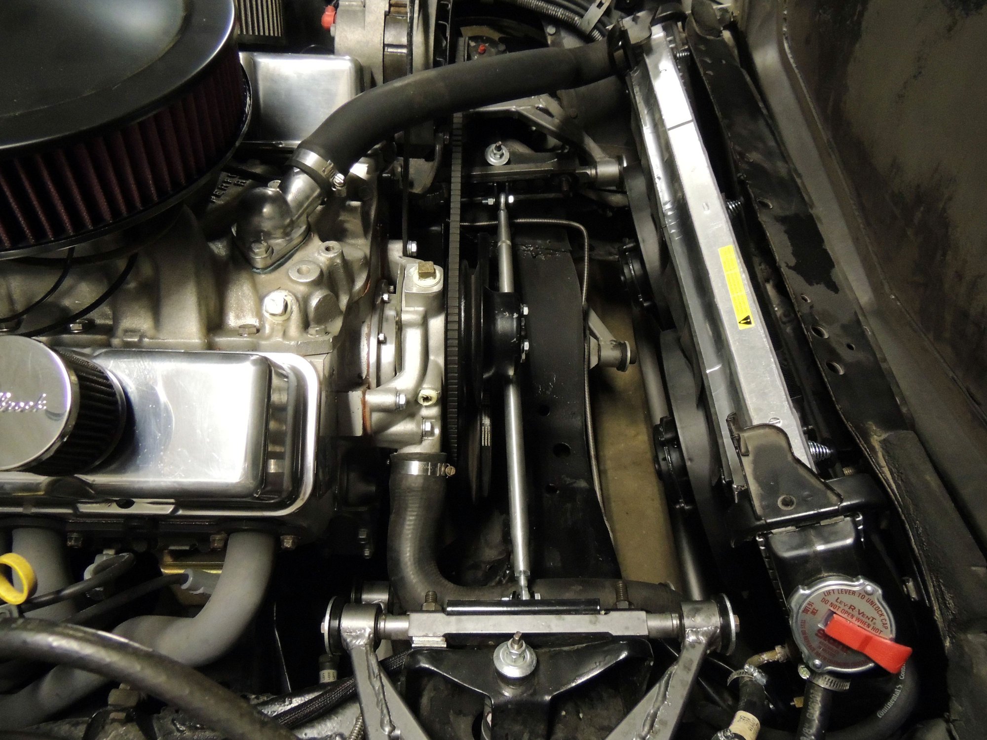

Here is a pic of my set up.

OK update. Seems to be working fine now.
I jacked up the front of the car and put it on jackstands. Bumper was about 10 inches higher off the ground.
I drained some coolant so I could remove the thermostat without spilling any. I refilled coolant at the water neck and put the waterneck back on without a thermostat. Coolant was about 2" below the rad cap.
I ran the engine while jacked up with rad cap off. Coolant was flowing through the rad and almost immediately I could feel the lower rad hose warming up.
I let it cycle a couple times - coolant temp hit 190F where the fans come on and then temps would drop to 177F where fans shut off - stays stable cycling like this.
I topped off the rad while it was running.
I think I'll leave the t-stat off because it's actually working now and it seemed like it didn't take much longer to warm up. The electric fans wont come on until it's up to temp anyway. I wonder if it was 2 bad t-stats? Seems excessive to get air out!
Here are pics.
