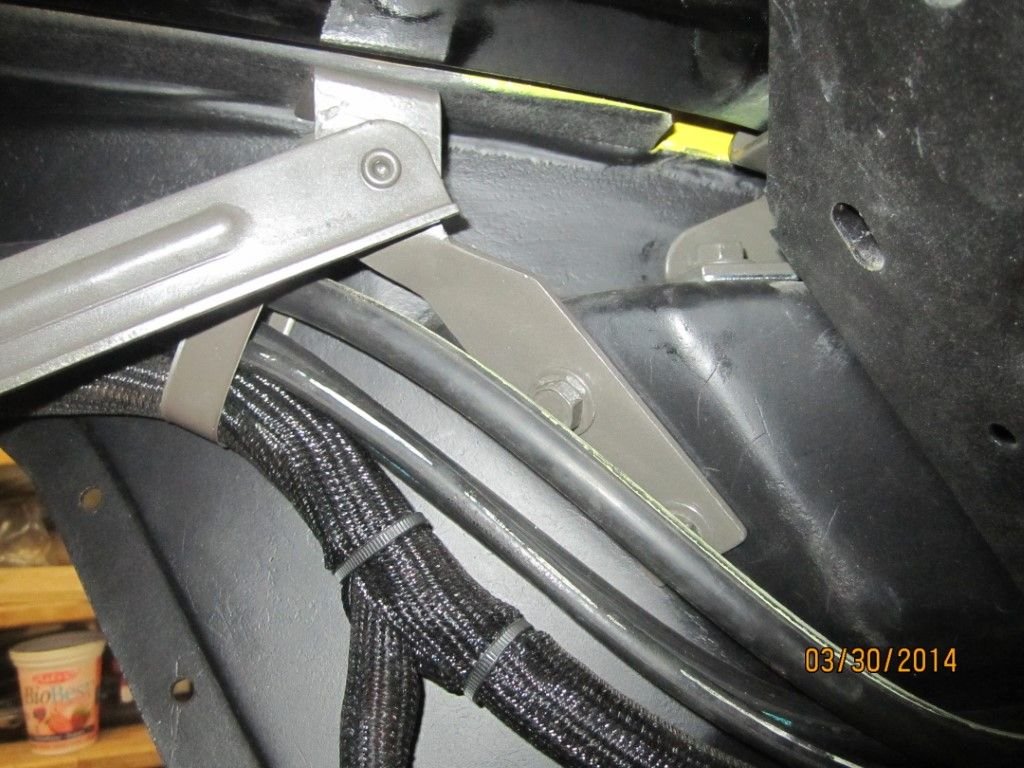

Interesting...my measurements match your measurements.
Looks like I might be in the market for a folding hood support...

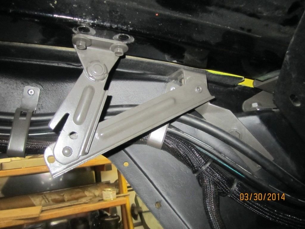

Here's how the folding hinge mounts on the inner fender to see if it's the same as your extended on mounts

Thanks for the reference images. I just checked and my current support bracket connects to the inner skirt with a single hole, not two like on your car.
So it looks like without any modifications I should be able to switch to the folding hinge designed for the single hole mounting.
