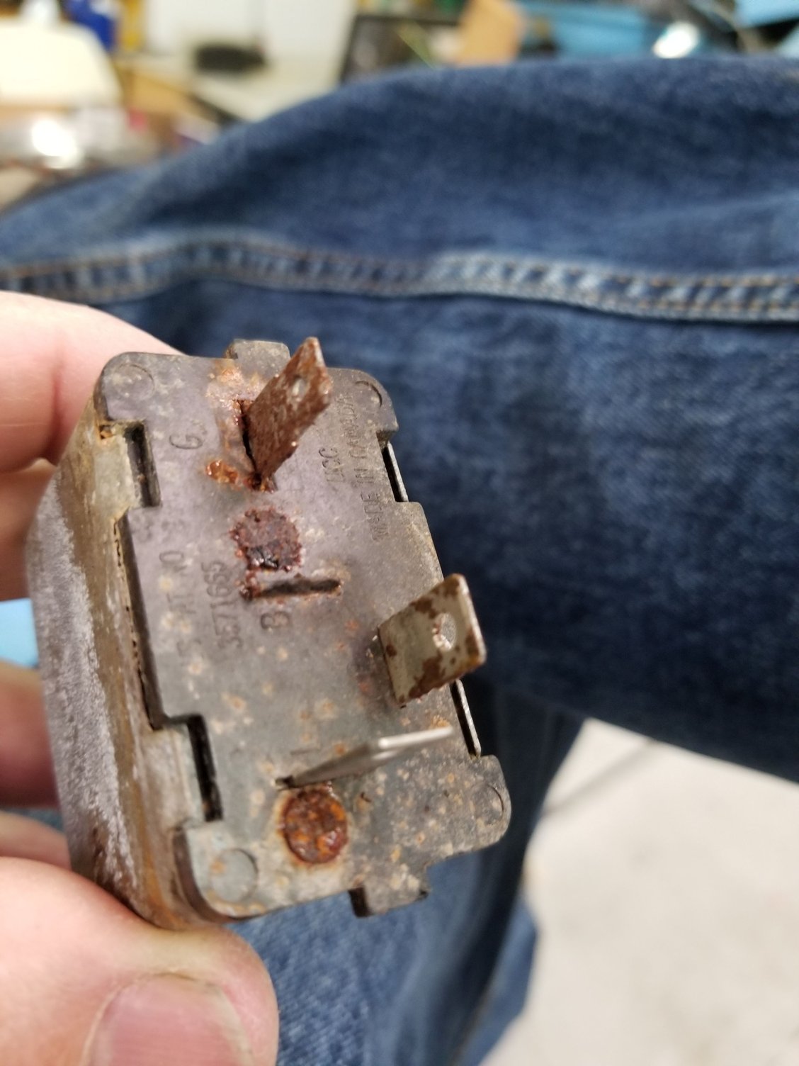

This relay? Is behind dash above fuse panel. What is it. In the pic you can see where a pin was but broke off. 4 pins total.

Looks like it's the rear defrost relay.

This relay? Is behind dash above fuse panel. What is it? In the pic you can see where a pin was but broke off. 4 pins total.
The last two digits "62" (GM# 527362) would be my guess...rear window defogger that comes off the dash harness, page 506 of the AIM. Shows the four pins.
