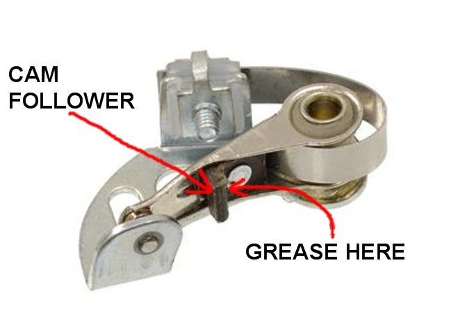

I have run points on many of my vintage cars and seldom have trouble with them. You probably know this already but, a common failure I've seen is when the points are installed and the small capsule of lube is not used. This will cause the fiber (or plastic) cam follower to wear out prematurely. Also, as VERYSOON said, extended key on power will burn a set of points as well.
