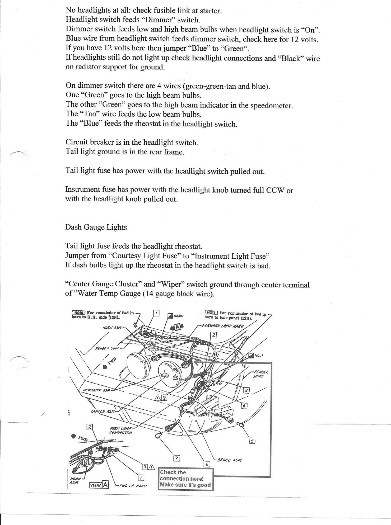

On my '73, the Owner's Manual says the Headlights are protected by a "Circuit Breaker". Anyone know offhand where it is? Inner Bulbs not coming on at all with the foot switch (but the BRIGHT dash light and the High Beam circuit of the Outer Bulbs work with the foot switch).

Old May 26, 2019 | 11:30 AM
Peterbuilt's Avatar
Peterbuilt
Joined: Aug 2006
Posts: 7,426
Likes: 1,559
From: mount holly NC
Old May 26, 2019 | 03:12 PM

Originally Posted by Peterbuilt
THAT, is a great deal of info there my friend. Thank you very much for the time you took in writing it up for me.
I will FIRST check that connection you annotated in the box*; as soon as it stops raining. SoCal weather has sucked for a week and is probably responsible for the disasters throughout the country.
Thanks again.
Steve
* Not the Bulb connections at fault. Re-sat them all with no change in light status.
