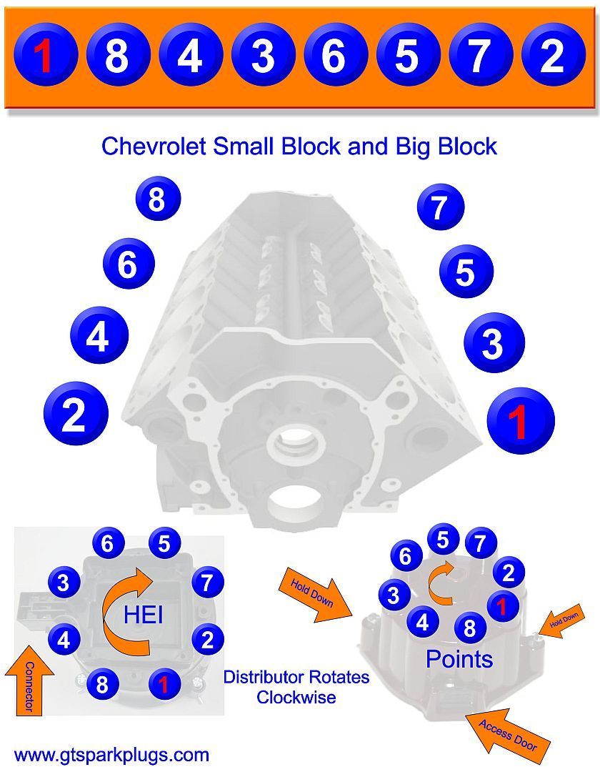

Originally Posted by Alex66
Correct, Ford engines have a diffrent firing order and so on... I have to say, i really like the crisp Sound of the early Mustangs too. But again, diffrent firing order than our Chevrolet engines!
compares these. They dont have a different firing order. Only number the cylinders differently. 18436572 is the same physical firing order as 54263781 on fords.

Fords has several different firing orders...there's conflicting info on the 'net. I found these:
1-3-7-2-6-5-4-8 5.0 Mustang order...different than gen 1 SBC
1-5-4-2-6-3-7-8 Some other Ford order same as Gen 1 SBC

You have to watch the numbering convention as Dusky said - there are only so many ways you can fire a V8 with a cross-plane crankshaft!
