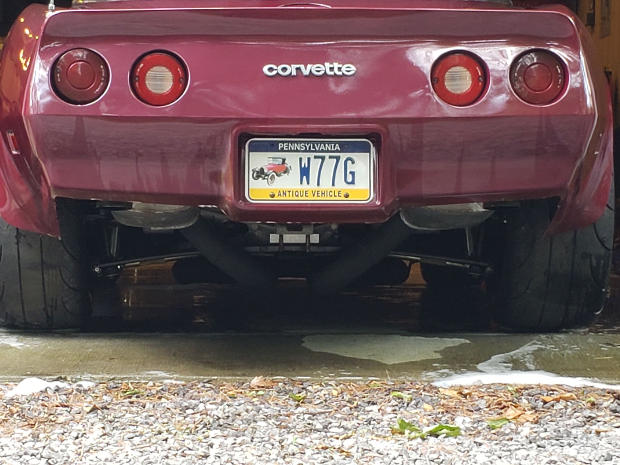

I'm running Pypes Violators which are stainless throughout, and a straight through design. There is almost no drone with the three inch pipes I have, and I'd imagine they'd be quieter with a smaller pipe size.
This video I took running open headers at idle, but even with the exhaust on the sound is pretty much the same at idle. Cruise speed the sound is very reasonable, but at WOT they absolutely roar.
