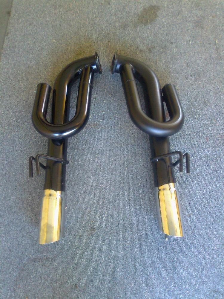

You can add "J pipes" to the mufflers you have now and that would stop the drone and improve the sound. Here is a example. Basic pipe with one end blocked off and the J part connected in front of the muffler.
it's a resonator of sorts

I've seen this type of setup before - there are Tundra guys doing this - sorry but it's ridiculous. Run a Corsa muffler at the end of the system - same type of concept. Mufflers like Ultra Flows, Magnaflows, & others that are straight through are not restrictive, but they do not do ANY tuning either. Like running straight pipes & the mufflers are simple expansion chambers. Personally, for an oval or box-type muffler, I like the concept & performance of the Cherry Bomb Vortex, as well as the sound quality.
You may think it is ridiculous but it's not, it works. Check out the Gen5 Camaro forums, they are doing this with great success. Your choice of a Cherry bomb vortex and Corsa add on is terrible. Those are some of the worst sounding POS on the market.

That "J" pipe thing is a "Helmholtz Resonator". Never used or needed one myself but If several people are liking it and repeating it, it cant be all that bad.
You should see what is in my stock Gen 5 Camaro mufflers.....Basically nothing. It's just about an empty suitcase.
Hi!
To be really a**l, it's a 1/4-wave resonator - similar to a Helmholtz, but very narrow-banded.
There is no point in fitting one just anywhere, you need to know what the resonances in are etc., but a well laid-out Helmholtz-system can work very well indeed!
