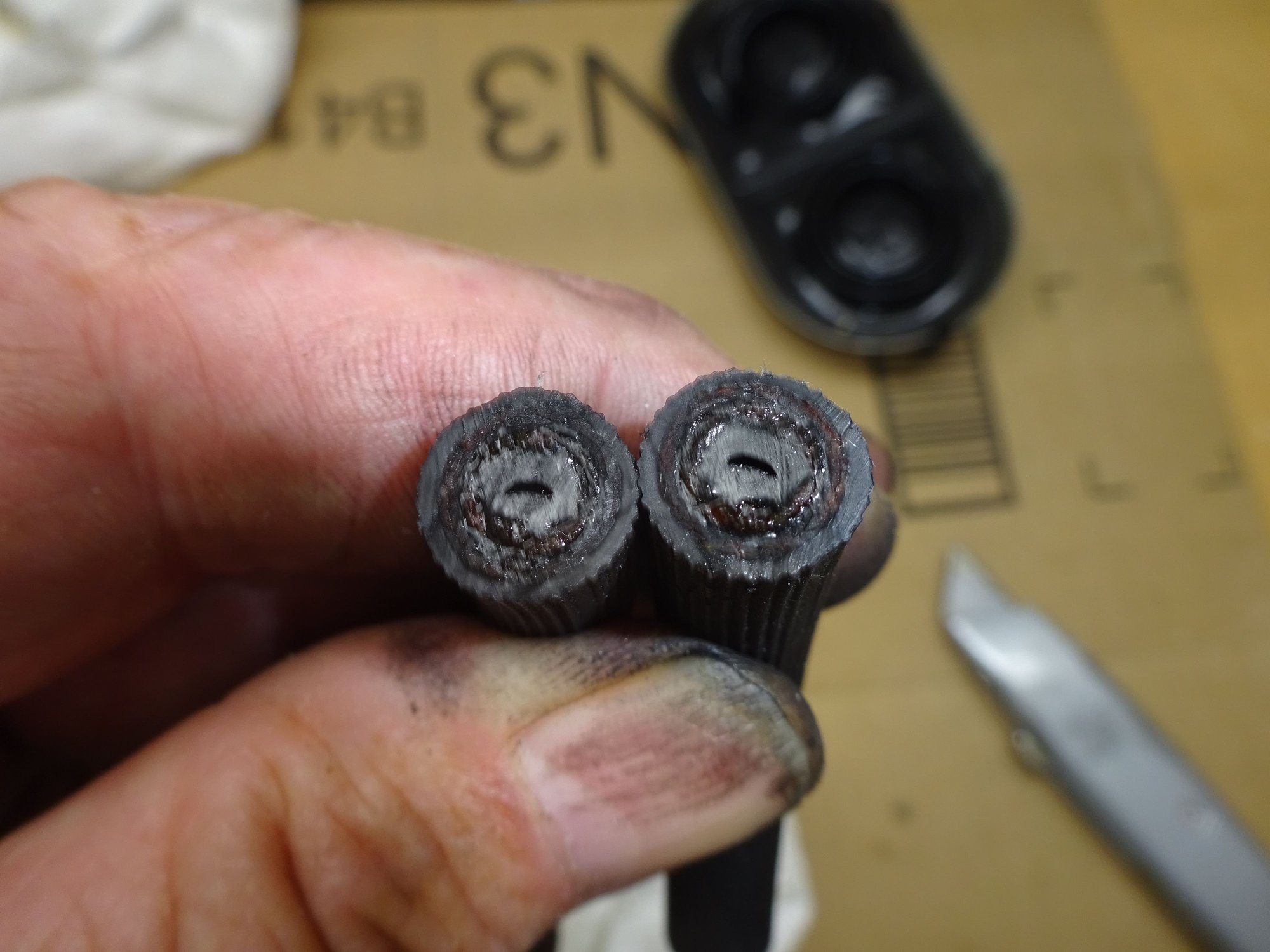

Lately my '77 has started pulling to the left when the brakes are applied. I plan on looking closely at the right front caliper thinking maybe it's leaking fluid on to the disk although I haven't seen any evidence of a leak - nothing on the garage floor and the MC is full. I'll replace the flex brake line while I'm there in case it's collapsed internally. I'll look at pad wear but I'm not expecting to see an issue there. I'm leaning toward just opening the caliper up and rebuilding it. Anything else I should be looking at that might likely be causing the problem?

Pulled the line to the RF caliper. Cut it open to have a look. I've never seen what a brake line that is collapsed internally looks like but I imagine this is it. Gonna replace all four, bleed to replace all the fluid and hopefully call it good. Thanks redkenyan and jpatrick for the responses. I'll get back to confirm if the problem is solved.

Just to close this out, replaced all four flex hoses - and the LF steel brake line, the flare fitting was buggered up and rounded off when I tried to remove it. Bled the system, put two quarts of DOT 3 through it to flush it. Used my Motive pressure bleeder, so easy. Car stops straight and true again.

That was one ugly looking brake line. It was also good to replace all 4 hoses. If one looks like that, the other 3 may probably be about the same, or sometime soon.
