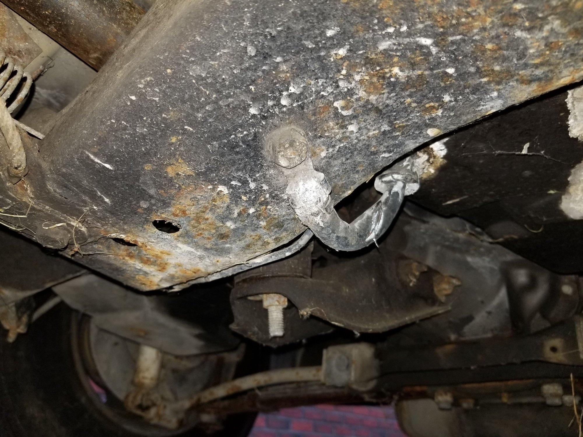

jack the car up. 1 cable bolts to frame at pumpkin right under battery (neg). the other one (positive) runs north thru trans tunnel. if frame end of negative looks like this replace it.

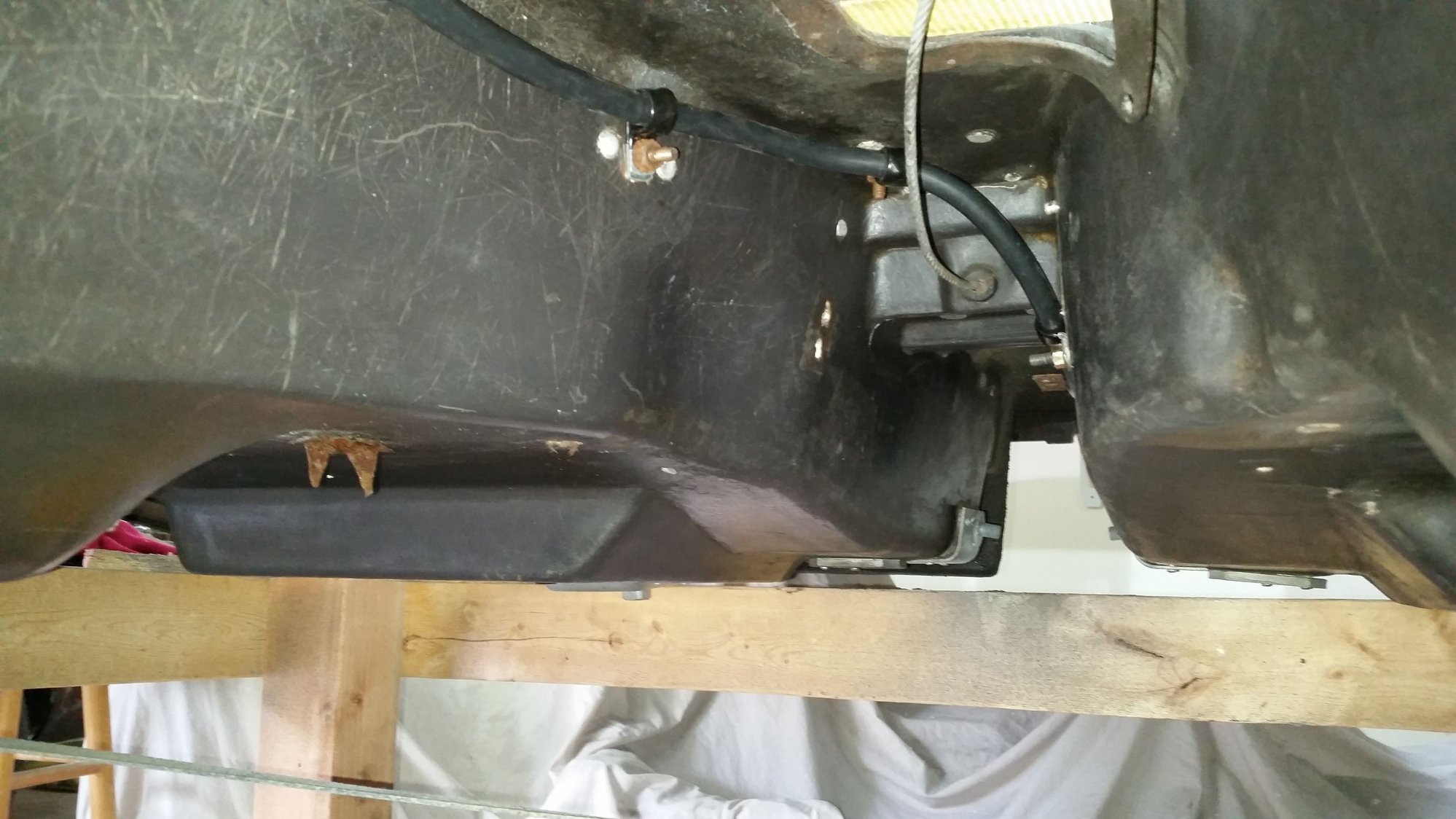

Positive battery cable run in tunnel before tunnel insulation for 69 application
Cable connected in tunnel

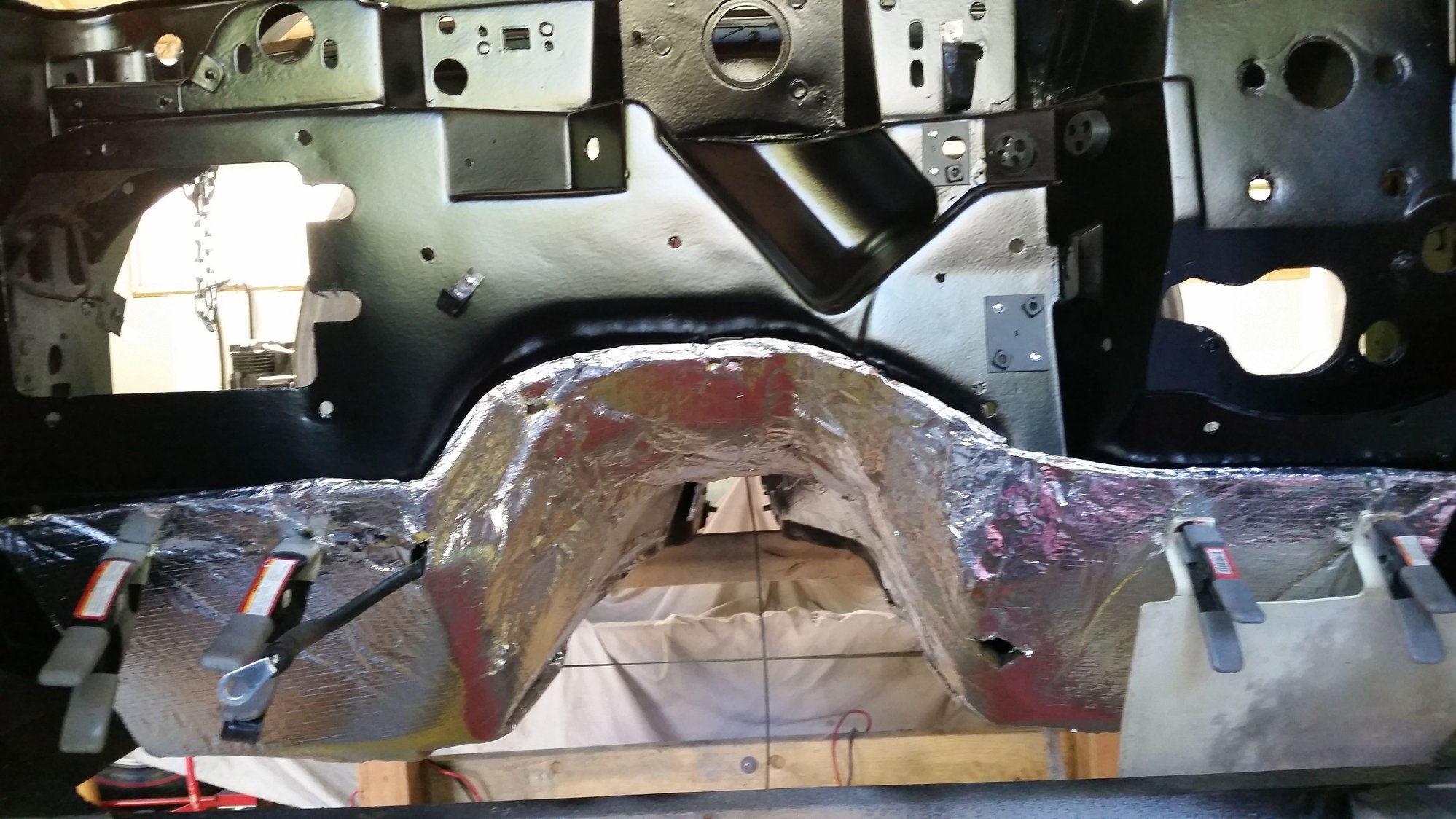

Tunnel insulation added over cable. Must leave enough cable to connect to starter at this point.
