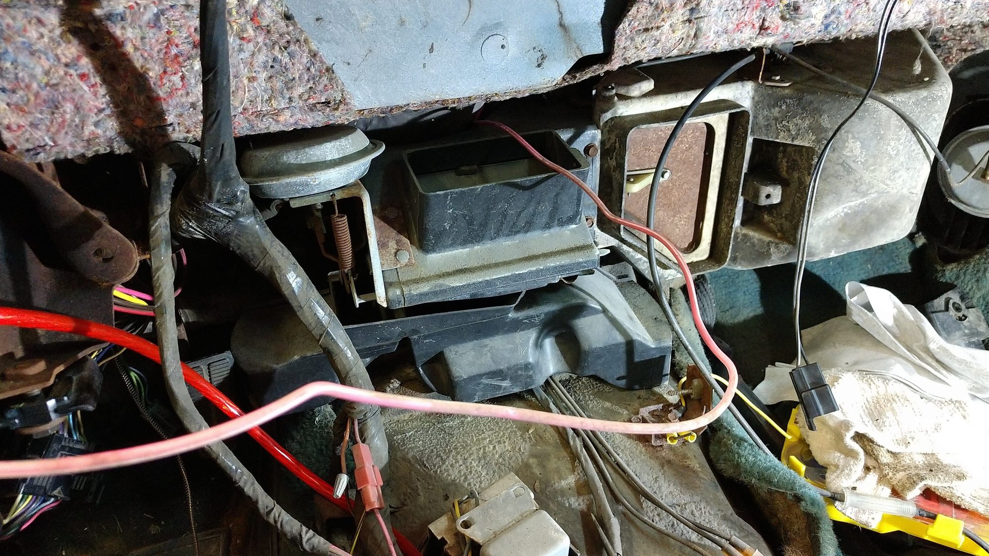

I have a 79 I'm working under the dash and have a ciouple wires I'm trying to ID. One is the pink colored wire going from the drivers side over to the heater box area and the other is the wire that looks like it has been cut on the passenger side. Also, what is the orange colored box for?

Orange box is the theater dimmer for your interior lights.
If it no longer works (and memory serves me correctly) you can just remove it and jumper the two white wires together. Then your interior lights will work as normal.
