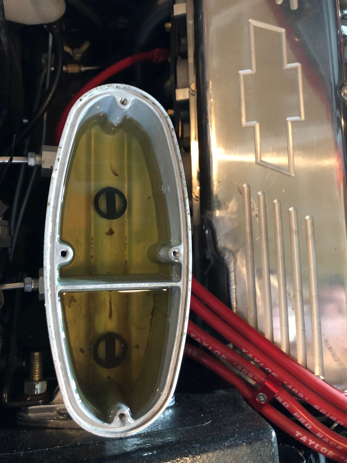

Please post a picture of the brake fluid in the bowl
If the fluid is black or dark/greenish, this comes from water entering the system and then super boiling, when this is done it creates air in the system, giving the symptoms you are describing.
Looks ok
