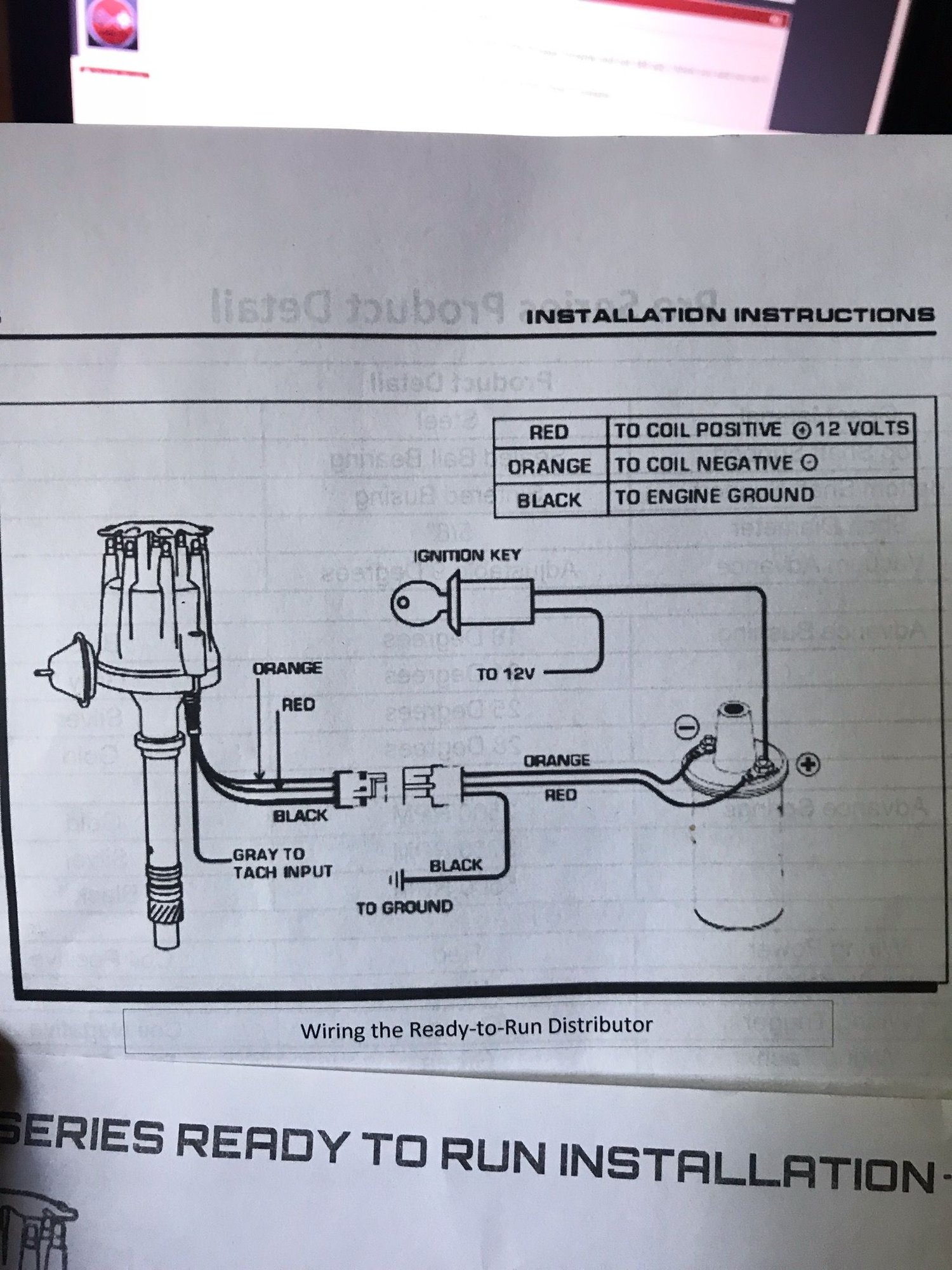

It all came in and I installed it per this wiring diagram:

seems the fleabay listing describing No-Name dist says it comes with instructions.
seems the instruction you link to are for an MSD brand dist.
Apparently No-Name dist is supposedly a copy of MSD dist ... But ...
... are the instructions same? Any discrepancy between the two instructions?

This is the actual directions...they look the same
