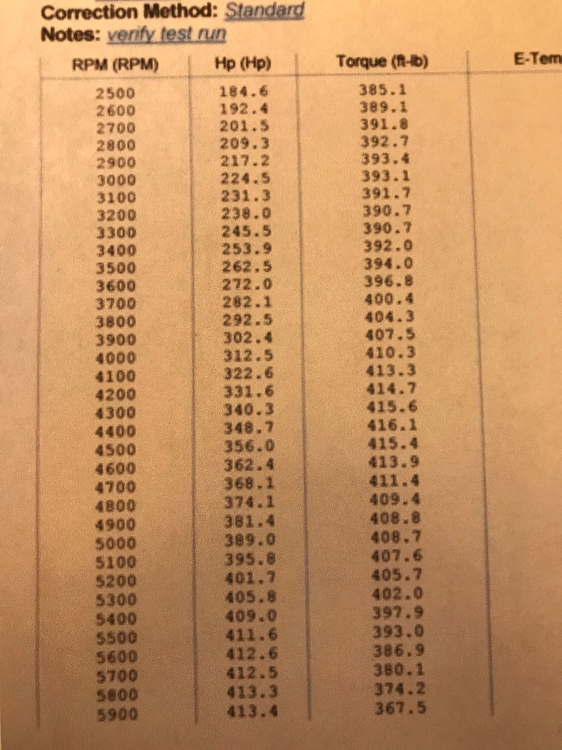

Heading for the dyno.....
just a 350....413 horsepower with 416 lb/ft of torque.
Not too bad for a 215 duration @ 0.050 roller cam with only .469 lift, 10.1 compression and AFR 180cc heads.It is a Chris Straub custom ground cam though.
File Type: pdf
just a 350....and for some reason I cannot get a good screen shot of the first pull. There is a pdf attached below. First pull tonight was 413 horsepower with 416 lb/ft of torque.
Not too bad for a 215 duration @ 0.50 cam with only .470 lift.
Sweet! Do ya think that Port FI & AFR heads lent a hand ?

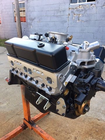

Old Jul 26, 2019 | 12:43 PM
MattoonVette's Avatar
MattoonVette
Living the Vette life....
Joined: Mar 2018
Posts: 555
Likes: 221
The AFR heads definitely help. The cam Chris designed was to work specifically with the AFR heads. I was hoping for 400 hp and he exceeded my expectations. The fuel injection may add a little but from all I have read it may not add much. Definitely a lot nicer to tune with though plus it controls the timing. I wanted the fuel injection for better drivability.
