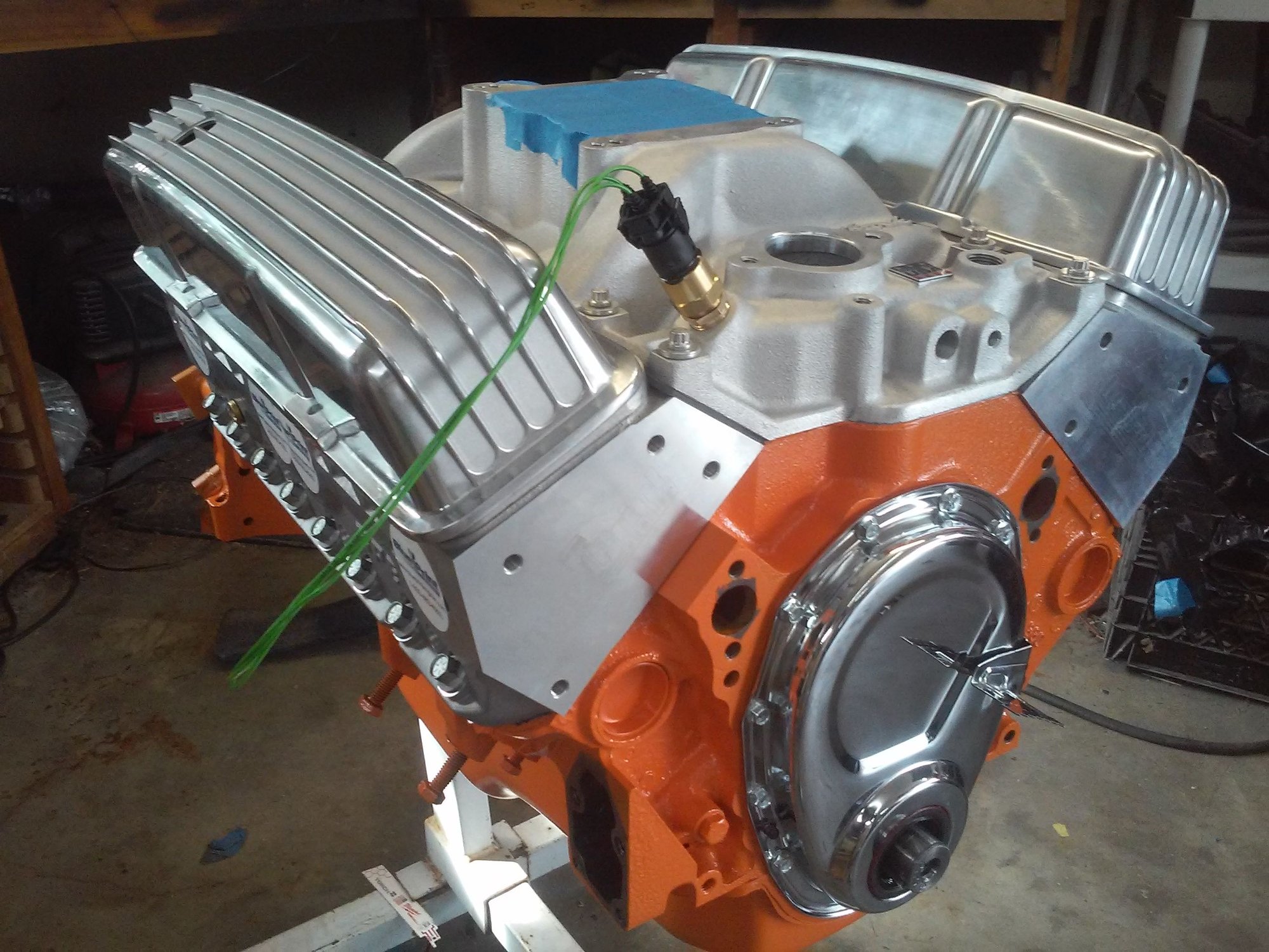

Getting closer got to show it off!

Looks nice!
So, what's in it?
seems later block, maybe blueprint alum vortec heads,edelbrock intake.

BluePrint 383 vitals
  1. BluePrint Aluminum Cylinder Heads - H8002K
    64cc chamber
    2.02" intake/1.60" exhaust valves
    195cc intake/75cc exhaust runners
  2. Cam Type: Roller
    .528 Intake .536 Exhaust
    221 Intake / 226 Exhaust duration
    @.050 - 110 degree lobe separation

Looks Great! It’s a BluePrint 383 - I’ve seen some of your other posts. Looks nice and clean.
Lower duration and quite a bit of lift. It’s gotta be a torque monster! What does the dyno sheet say?? That’ll be a fun motor.

Dyno sheet. Going to be ablast!

Holy schnikes... over 400 lb ft from a high idle to 6000 rpm! I did not expect the 436hp, but you have the cubes and heads. Really, really nice! That will be a roasting beast! Good luck with the install.

Nice and clean! Super flat torque curve. Tons of power but should have great street manners with that low rpm torque too.

gmcman52 Eddie Motorsports Aluminum Valve Covers MS108-29P I wanted the vintage look and these fit the bill. They are tall to clear roller rockers.
