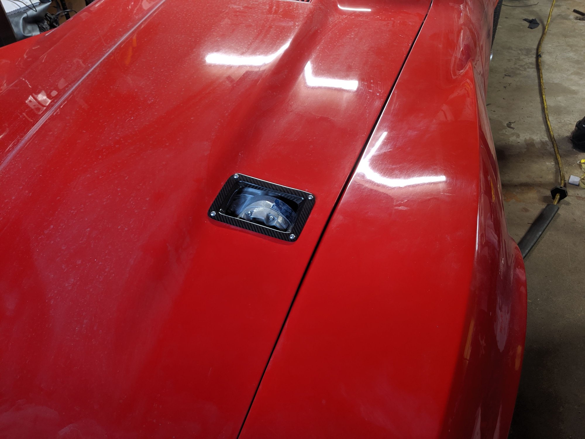

Well some will like it, I'm sure many will hate it, but its functional and it's what I'm rolling with for now. I'll come up with some kind of cap for when I wash the car / get caught in the rain. The Gap is because hood isn't fully closed in second pic.

Old Jul 26, 2019 | 09:38 AM
derekderek's Avatar
derekderek
Posts: 13,082
Likes: 3,399
From: SW Florida.
It was gonna eff up the hood anyway. This way you don't need to deal with paint, at least for the time being.
