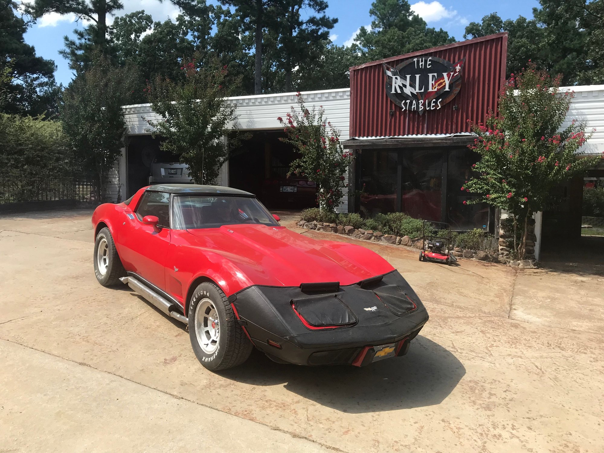

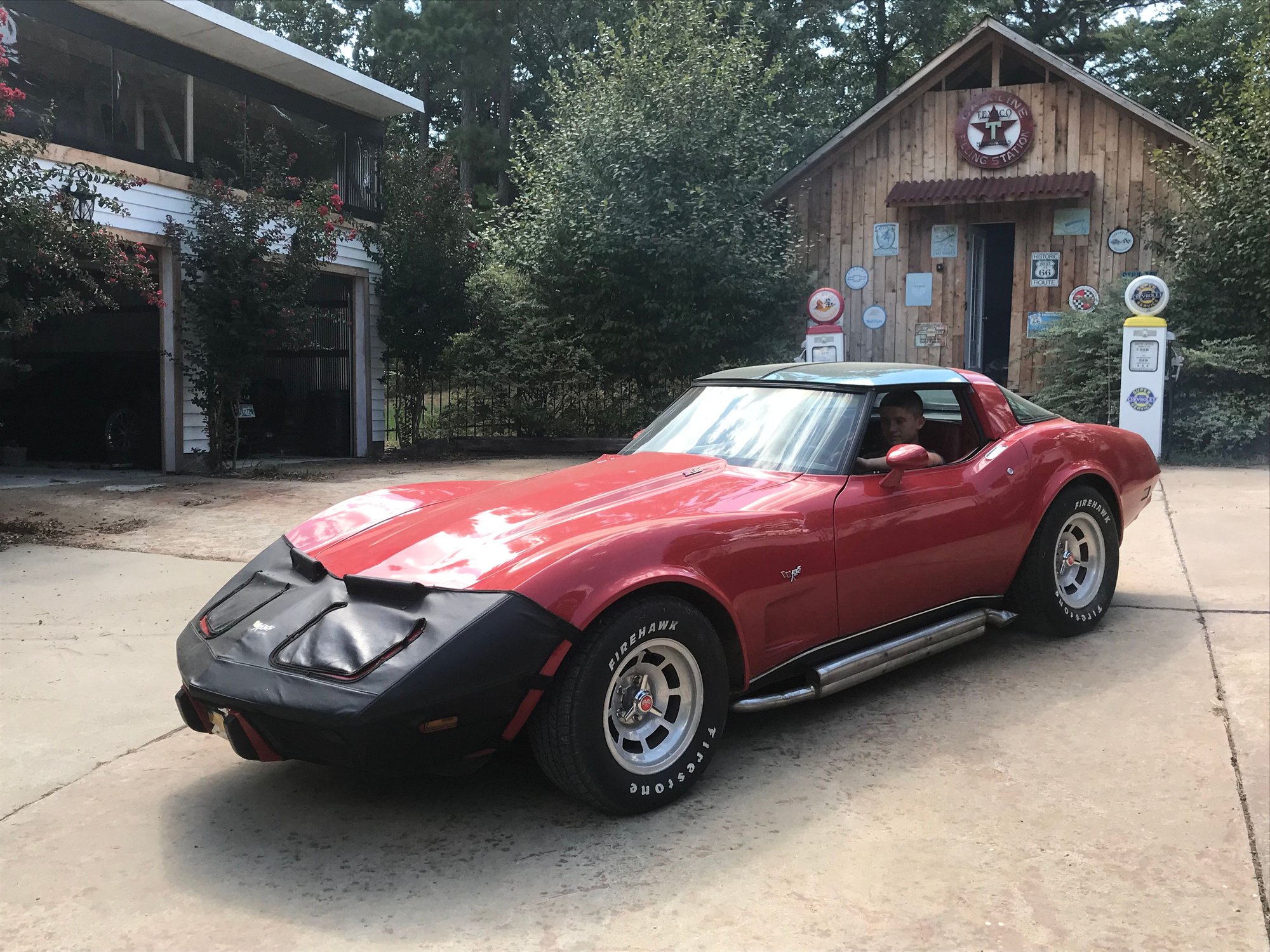

So today my son and I finally got around to installing side pipes on our C3. Now we just need to give her a good wash and wax, and go for a drive.
Question for anyone who has, has seen, or knows about side pipes: the front of the pipes barely touch the aluminum trim piece that is screwed into the car, below the doors. It’s the same on both sides. Is that normal, and ok, or should it not touch the aluminum at all? It doesn’t touch the fiberglass anywhere.

Those pipes are designed to have the aluminum rocker panels removed and have covers installed over the pipes.

Absolutely cover those! You will get a 3rd degree burn and it hurts! Ask me how I know..
You can get cheaper fiberglass covers that are paintable but those aluminum side rockers need to be removed to install the covers.

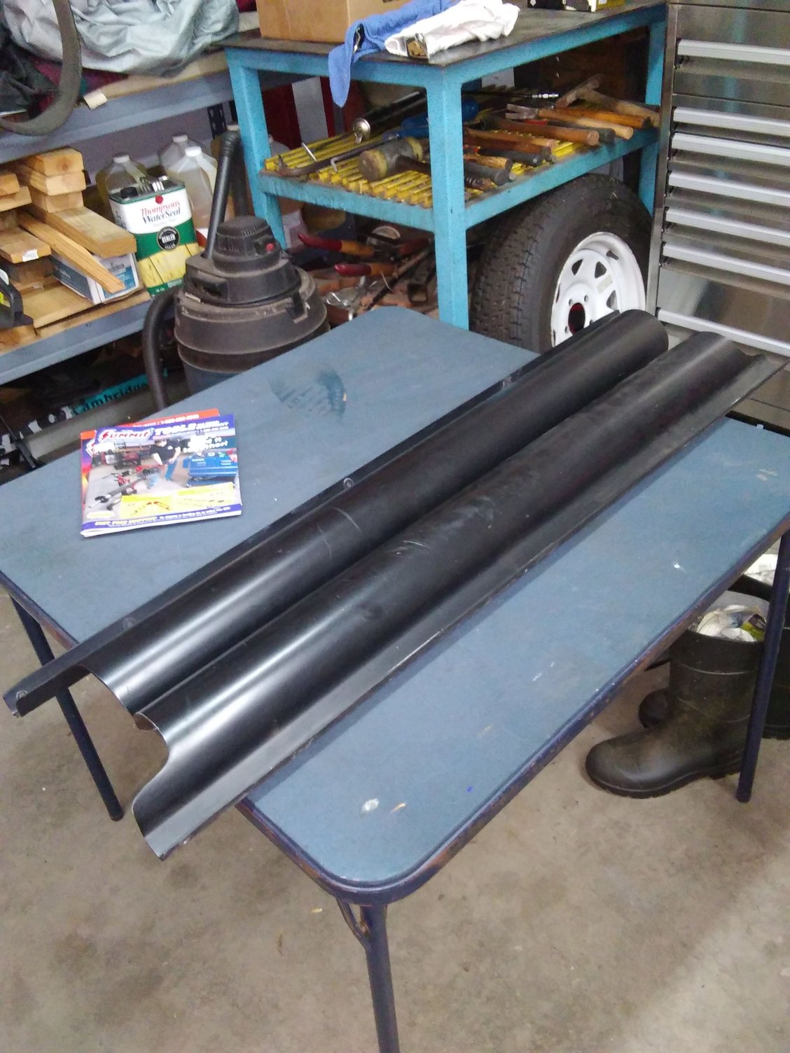

I have a pair of ecklers fiberglass covers that I took off my car. They attach using the holes that the rocker trim uses. I wanted the trim back on so I make my own covers. You have to trim the rocker trim a little but no big deal. 50 bucks plus shipping

So do those cover the whole area that the rocker trim covers? We took the aluminum rocker trim off today and the way that area below the doors looks, definitely want to make sure whatever I get covers everything that the oem rocker trim covered.

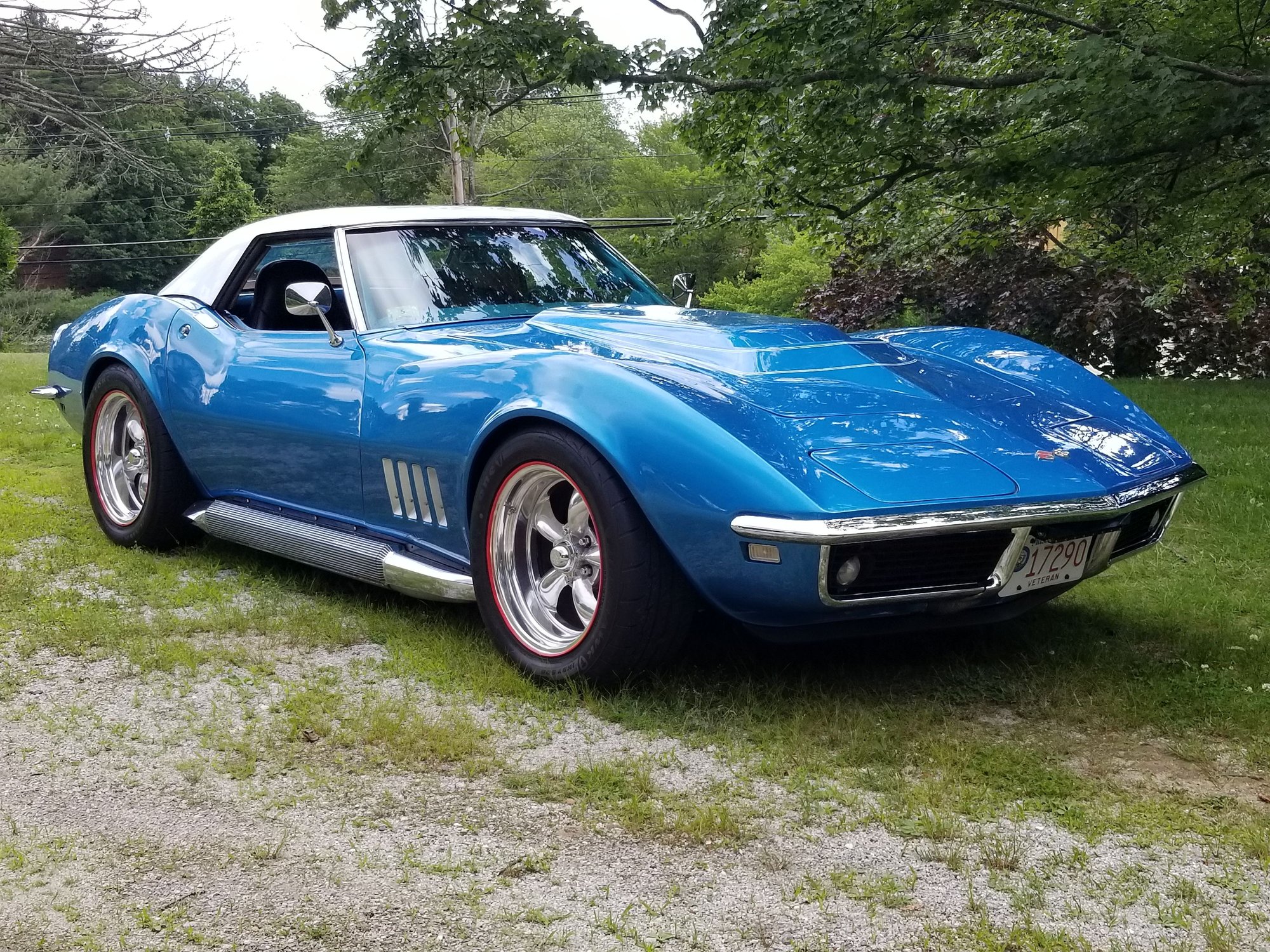

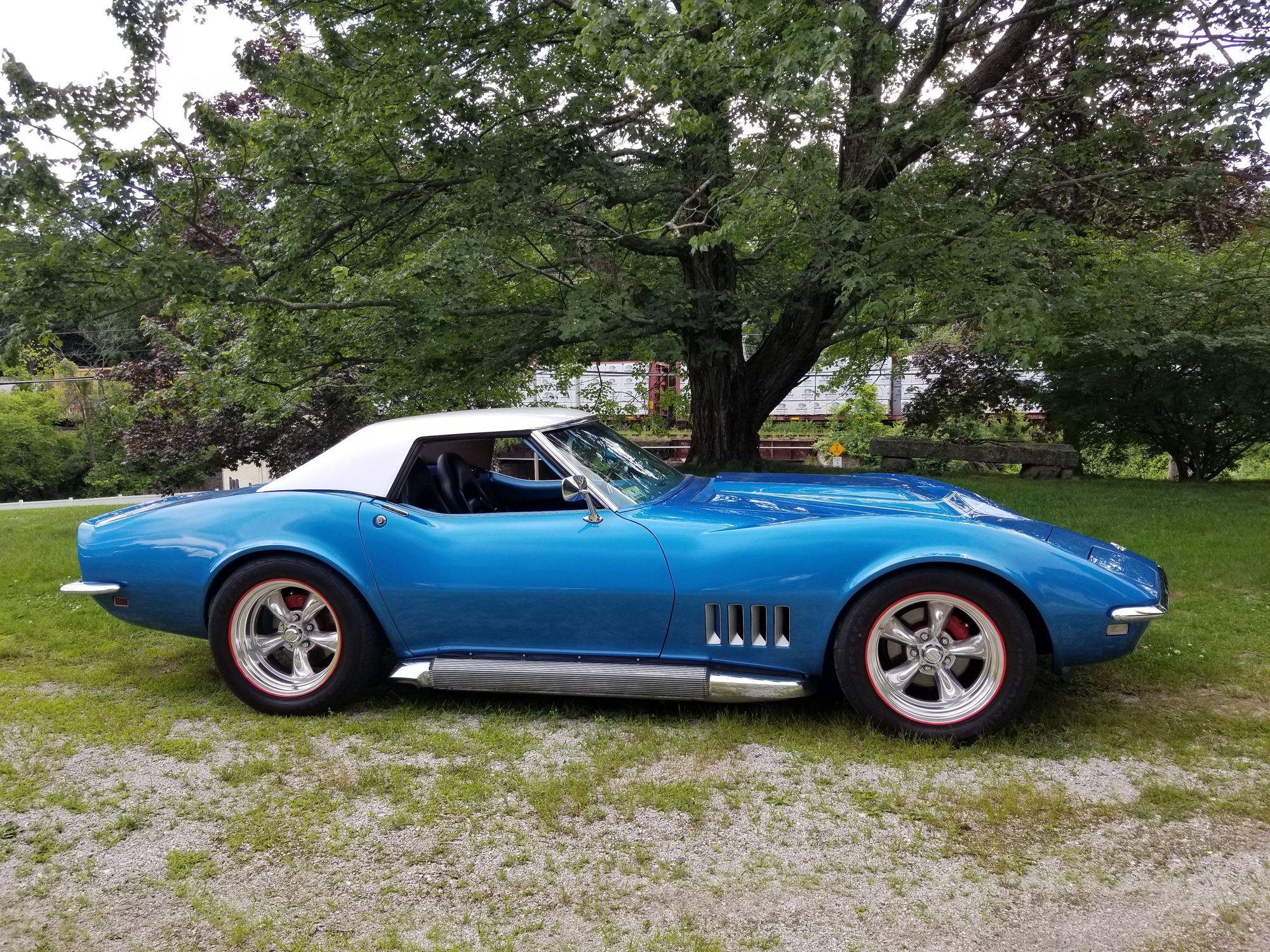

http://www.cranescorvette.com/corvette_side_exhaust.htm
These are very expensive , but imo they look the best as they are factory style (alloy) and made to suit your pipes.
You can get fibreglass copies of these and they need to be painted .Imo they dont look as good but cost less than half of the alloy ones.
The factory pipes (n14) stopped in 69 but the pipes and covers will fit later c3 .
those are for the hooker style pipes which are completely different than the factory style pipes.

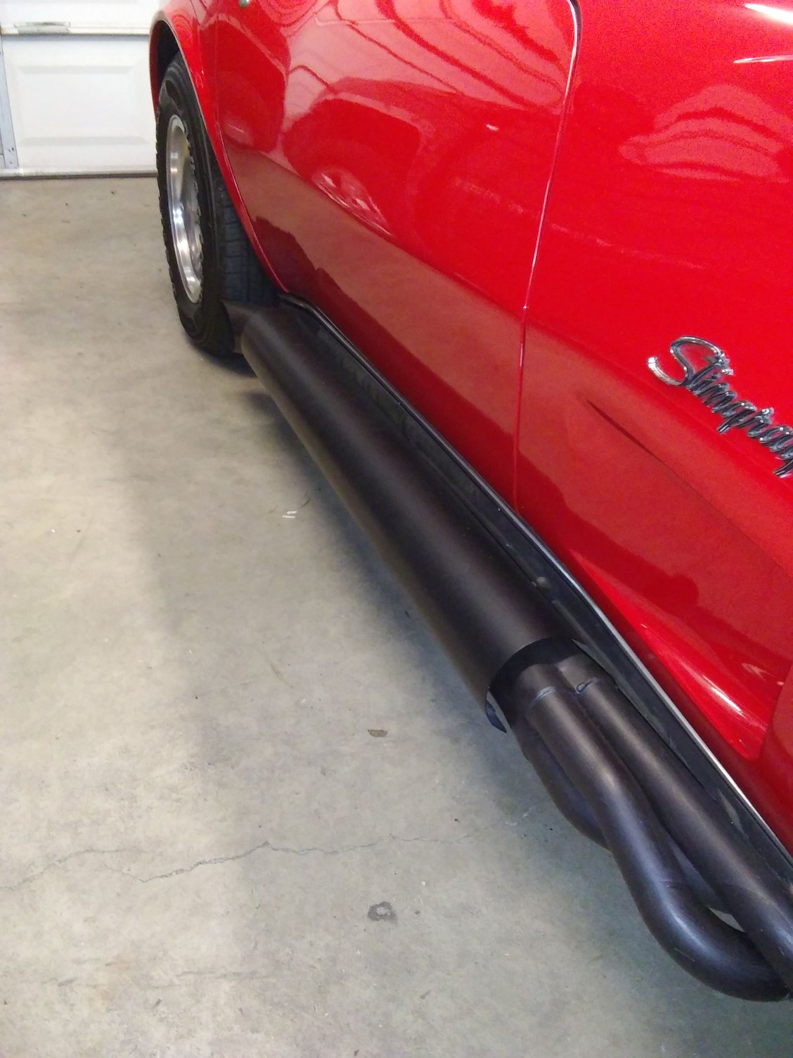

You only installed HALF! Where are the covers? Why is the rocker panel EVEN THERE?(it'll probably melt!)....if you look at pix of correct original side-pipe cars, you'll see you're half done!
The AIM has a good couple of pages on this install.
