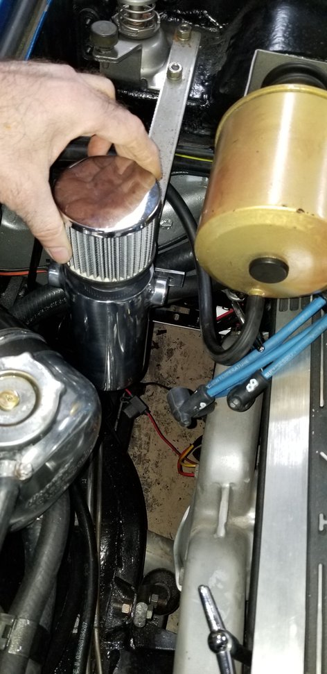

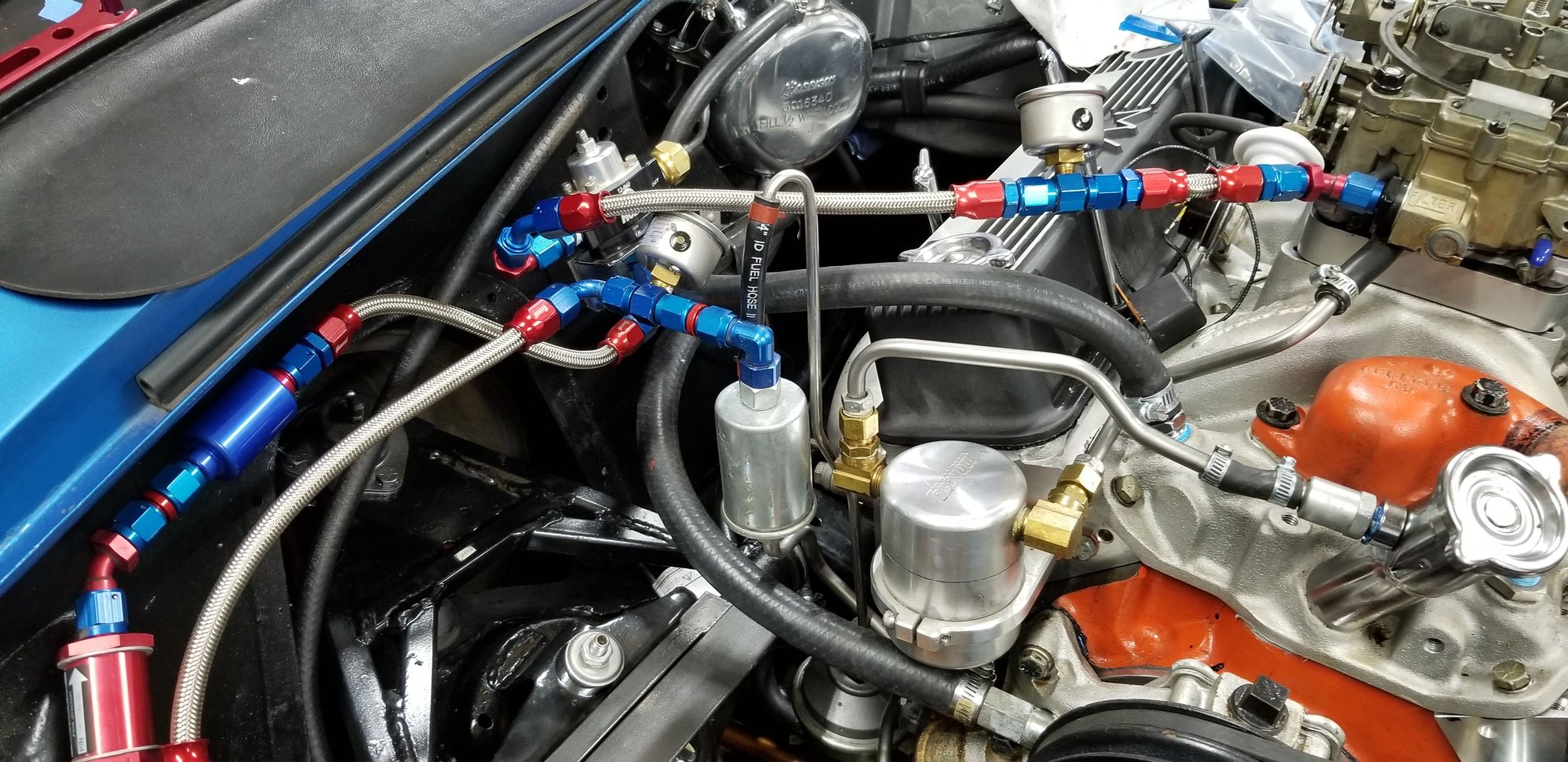

I use one because I like to keep oil out of my cylinders. I have a moroso one when I used the air breather as an intake filter. I stopped that and added a summit separator that acts as a vent and an intake under high vacuum
This is the summit can
This is the moroso. I've caught some oil in it but never measured it. I good couple of ounces every so often. It goes through a PCV valve in the fill tube
