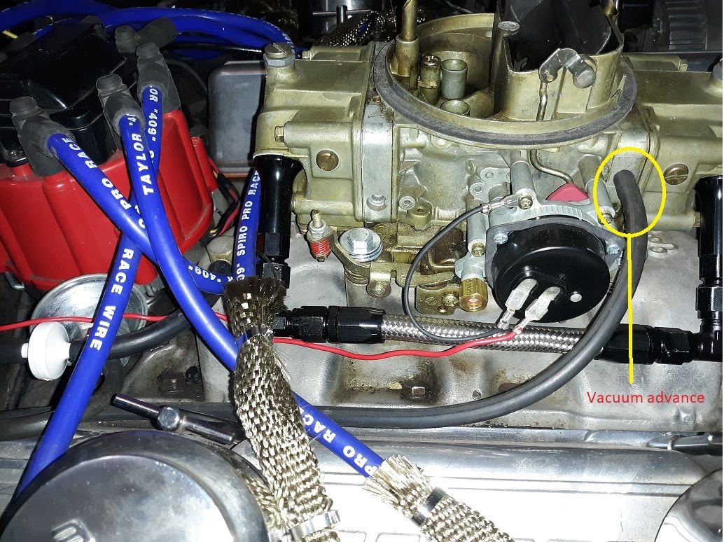

That reads like you have the connection on a "ported" vacuum port on the carburetor. Idle vacuum should be at the highest at idle with the throttle blades closed and connected underneath the carburetor (not on a ported vac port).
Min vacuum for good operation of accessories is 12" Hg from what I've read - though many say less than that works.

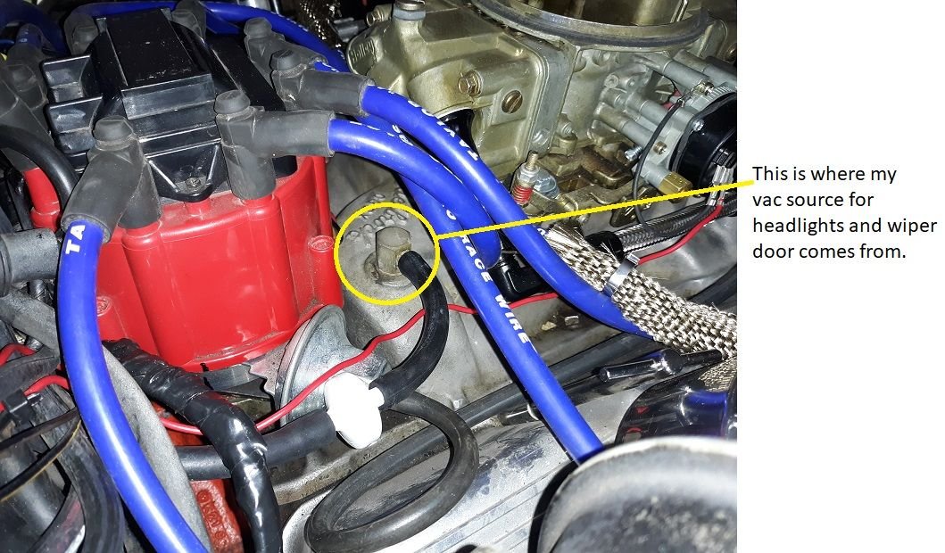

Thanks for the input - just starting to get some of the engine pieces straightened out after buying the car. I get my vac source for the headlights and wiper door from the manifold, at least that's how the last owner
did it.
For the vacuum advance, it looks like he used the ported vac. It has never idled that well, and I am thinking maybe to move it to a manifold vac source?

So with a good manifold vacuum source I expect the headlights should have enough vacuum. It reads like you have them connected to some other source or the vacuum lines are mixed up.
I think you understand now how they should operate and just need to sort the lines out.
