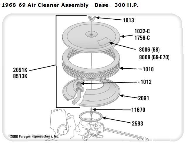

Should be a sweet running street engine. You got a good deal on a solid car with a solid engine. Couple recommendations:
  • You need to figure out if it will run on 87 or if it needs 93 octane not to ping.
  • Make sure you buy zinc additives for your oil or buy old fashioned oil with zinc (like Brad Penn) if you want that flat tappet cam to live long. If you do, it will, as long as prior owners did.
  • Please buy a larger air cleaner like a corvette 14 inch drop base chrome top one, I feel that small one is strangling your engine. May be worth 10-20 hp.
  • Valve covers? Mostly looks, but I'd prefer closer to stock, it's no race motor. L82 ribbed ones would look great.
  • Check your PCV valve and make sure it is in one valve cover and the other one has a breather. With a working PCV system your engine will run cleaner inside and you'll be happier. Personally I'd drop the the race "breather' on your left valve cover. The AC air cleaner has a hidden breather inside the air cleaner and it will look cleaner under the hood.

Where do I find that 14 inch air cleaner

Here's one example from Paragon. You have many options, diff level chrome on cover, etc. LT-1s had the vent pipe come out at a diff angle, most others were the same, SBC & BBC, Roch & Holley carbs.
