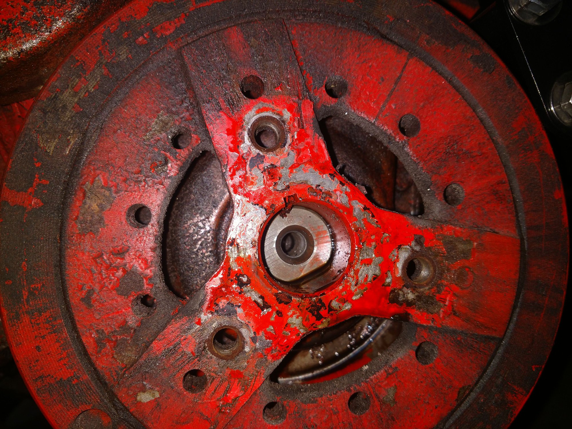

As long as I have to wait for my power steering pulley, I decided to replace my front crank seal. I got the seal that is offset 1/8 of an inch forward, so it wont be riding on the old wear spot on the balancer. Great idea. Now with the crank pulley off I got the pulley number,,,, it's a 3858533 BJ like we thought. Can anybody tell if the balancer is on as far as it should be? Maybe this is why the lower pulley doesn't line up with the upper pulley.
Edit: In looking at the back side of the balancer it's almost flush with the timing cover. I guess it's all the way on.
