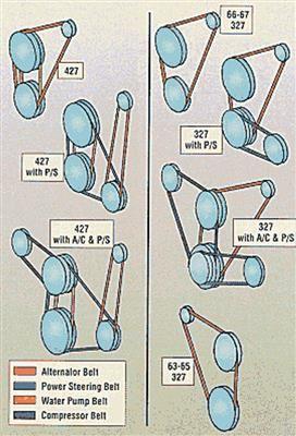

Don't know if this will help or not:
This diagram is from Corvette Central's site and references 64-68 327s. This is the link to their page: https://www.corvettecentral.com/c3-6...0-350hp-302514
I went through a similar problem when I added AC to my '73. Somewhere either on a vendor's website or on this forum are some belt diagrams similar to this one that has part numbers for the various pulleys. I had to replace one pulley at least but I've slept since then and can't remember much more about what I had to do.
DC

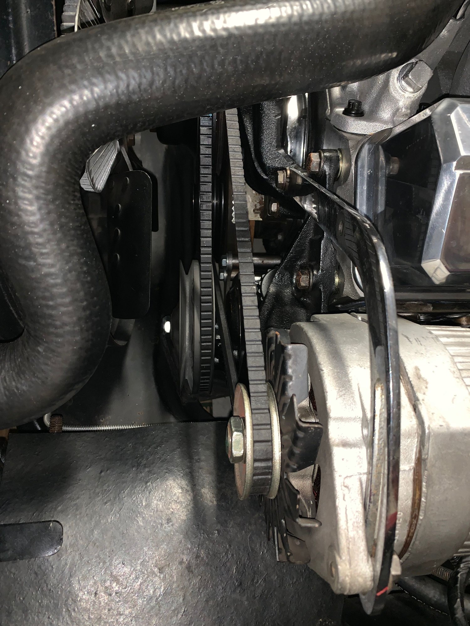

I'll need to take the pump pulley off. I will get the number off of it. I took a pic of the lower pulley,,,, no numbers on it that I can see. Here is a pic of the shorter column and rag joint installed.

I'm thinking you should not be needing spacers. With the pulley part numbers we should have all the info necessary to get you lined up unless you got some oddball PS pump. Note that my PS belt goes to the center crankshaft pulley (is front pulley if the 3rd add-on pulley is not attached) only, and does not go around the water pump pulley.... I mention that just to let you know that it doesn't squeal.

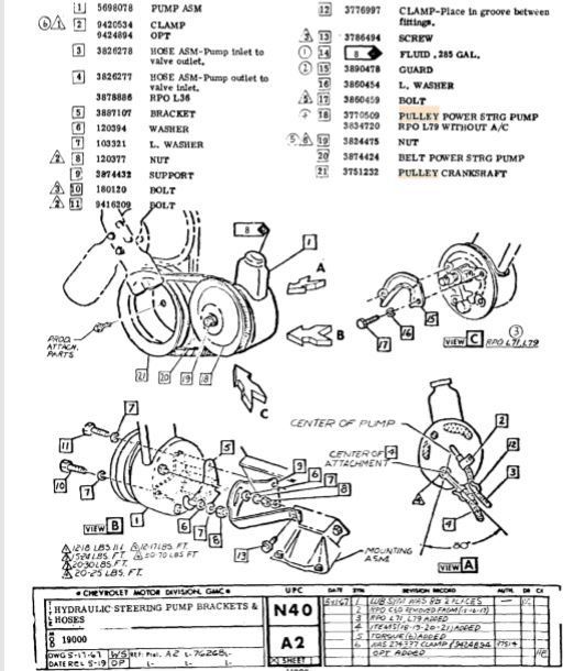

It's all good to go around the water pump. I'm a bit lost as to what pulley your ordered, but below is the one that is on my car and an image from the assembly manual. The only reason I have the forward-most pulleys on mine is to run the A/C ..... before that I was running with the PS as shown and did not have the forward-most pulleys installed. (From all I can find the 1968 L79 could not be had with a/c and ps).
Do you have an assembly manual?
https://www.ecklerscorvette.com/corv...974.html#close
You can see that 3834720 is the pulley for an L79 without PS.

I went and looked up 2 potential pulleys that might be on your crankshaft. Per corvette central it appears the part numbers are on the inside...
https://www.corvettecentral.com/c2-6...-groove-302370
https://www.corvettecentral.com/c3-6...327-350-303210
The varied belt alignment options on our cars is interesting. On my '73, the power steering belt goes to the front, AC belt is inside (Vintage Air w/Sanden compressor) and then alternator belt is like yours. My belts don't squeal either but the AC belt hits the lower radiator hose shield after it loosens up a bit so I have to tighten it every so often. If I don't, the belt eventually wears from hitting the shield and breaks. It would easier to change if mine were like yours. I'm planning a swap to a serpentine system over the winter.
