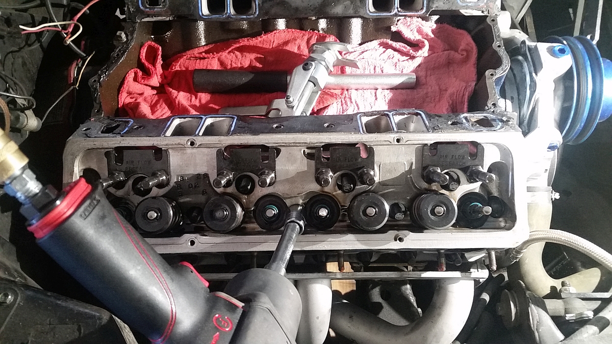

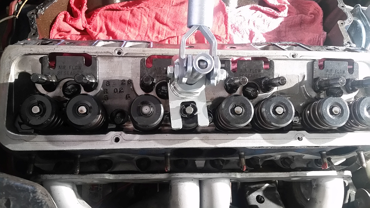

No, I've never had a H Roller cam in my vette. I have solid roller cams in my vette motors and early on I had a 383, 3.750 stroke. Until I figured out that the 3.875 inch cost the same price and you end up with a 396 ci. Which has a bunch more TQ
Yes AFR 210 heads and I originally used 227cc. But I quit chasing max performance. I've used up to 230cc on 350 ci. The 195 and 200cc are about the best option for any roller 350

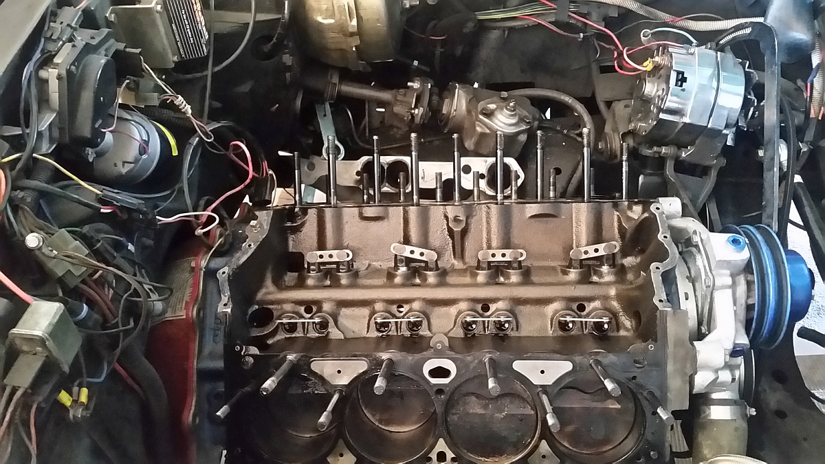

Go ahead and get the $200 balance. Stock blocks require grinding on the front cylinders pan rails because of the narrowing towards the front cylinders. I clearance the rod bolts about. 040 when I do stroker kits for customers.
My shown blue block has a stroker 8 quart RR pan for up to 4.00 inch crankshafts
