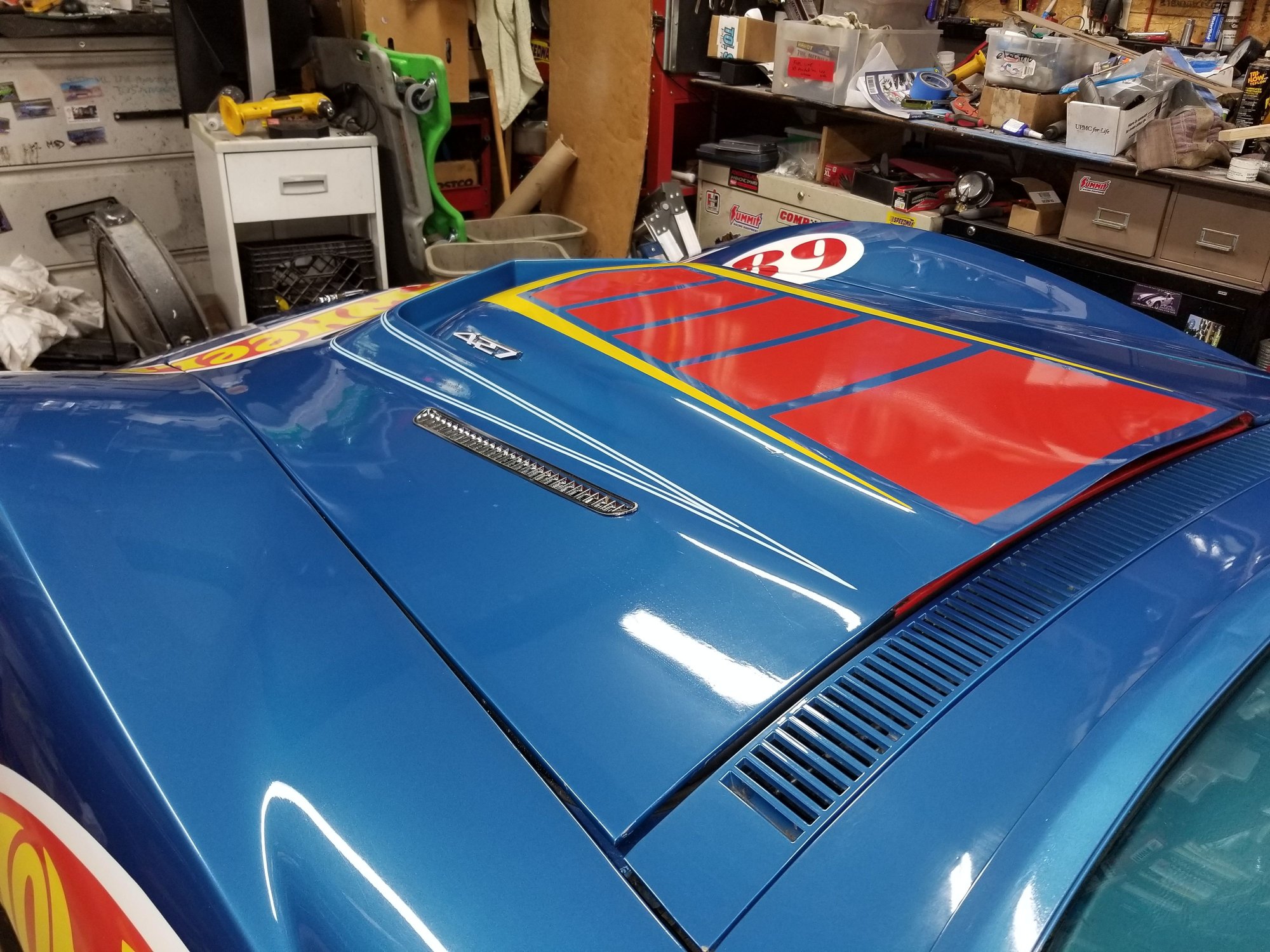

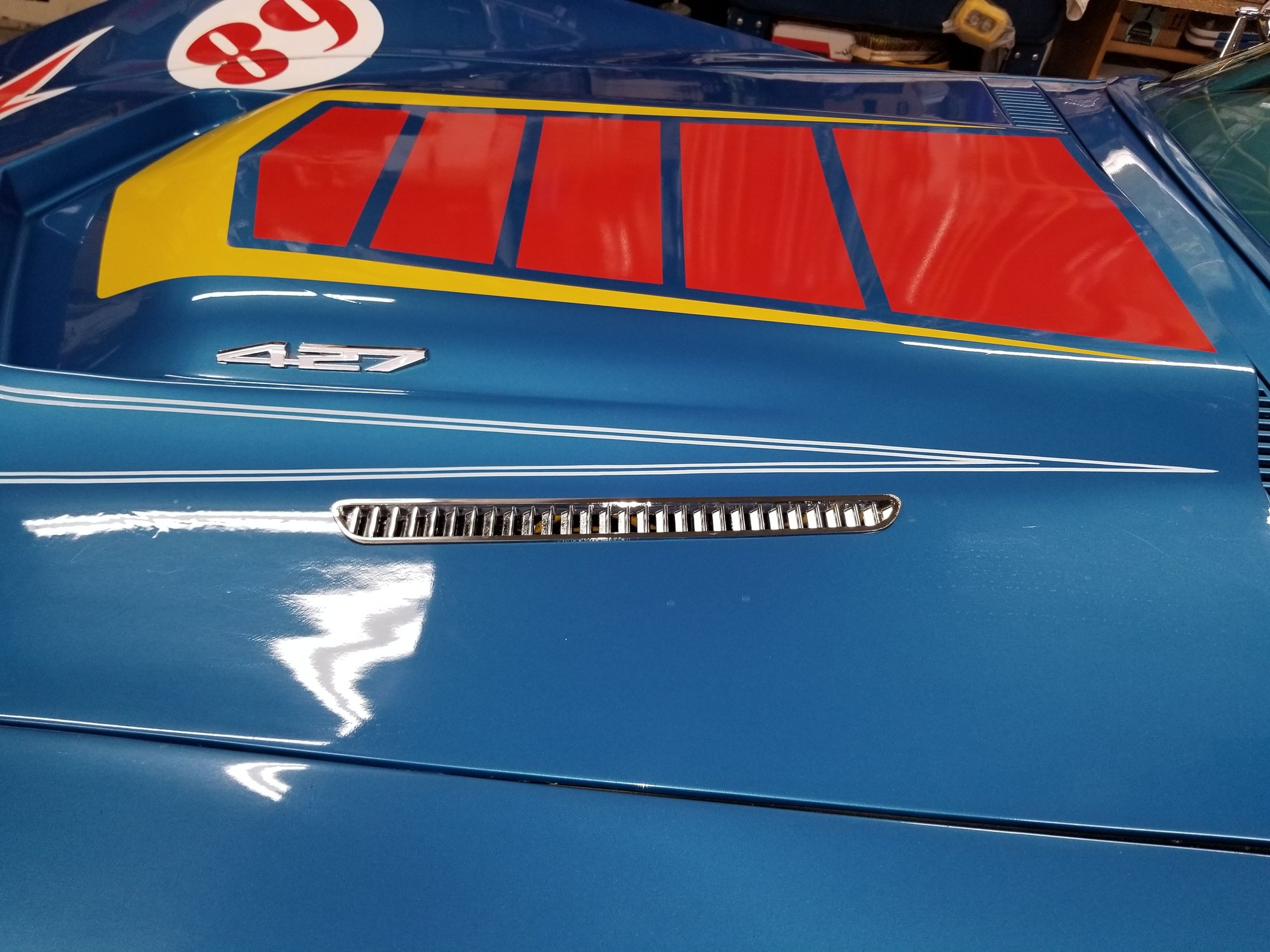

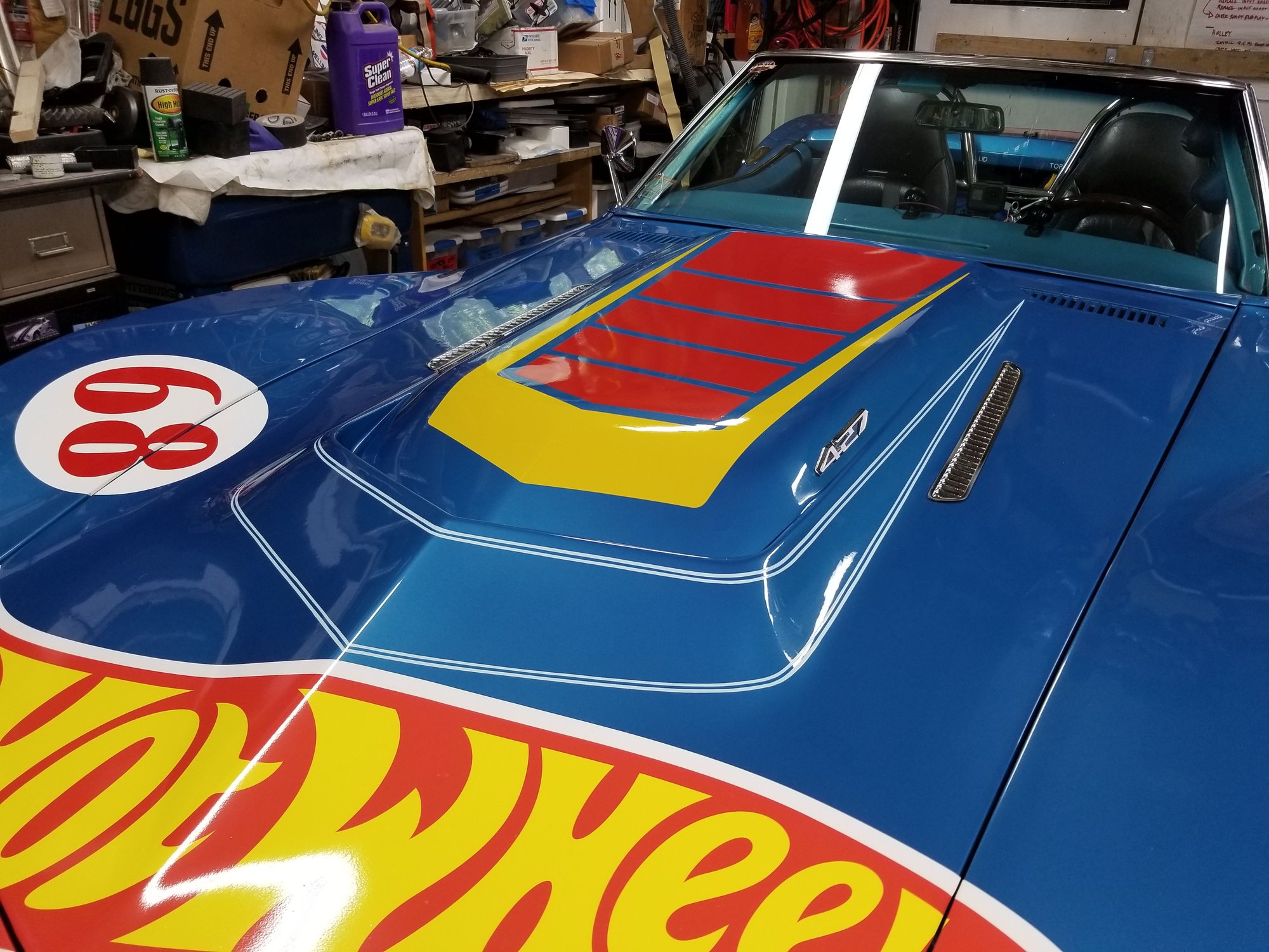

I would get your headers ceramic coated. Its usually around $350 for a long tube set
The other solution is using hood vents above the headers. Even the small 66 big block hood vents work
