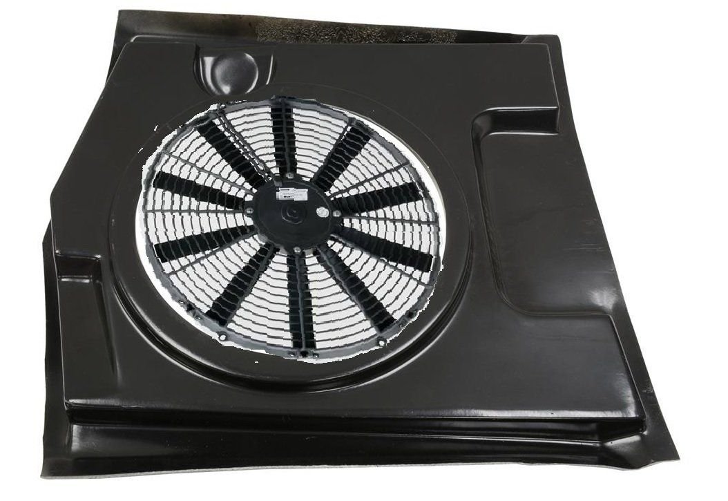

You really wanna get some heat out?
Here's what I thought would be a "cool" idea- especially with a low profile LS engine- L88 hood with a fan- artist rendition

Just putting a thought out to the more experienced Vette owners. Would it be beneficial to put fans in the fender area vents to help extract some of the heat?

i have seen a photo / write up on the net years ago where somebody mounted fans down in the fender vent area to suck hot air out when stationary.
may have been a race car.........
think they were like large computer fans, 6" or larger, in behind the fender vents.
not sure how well it / would have worked,

That is exactly the type of fans that I was thinking of. Computer fans except I don't think that they are weather resistant
