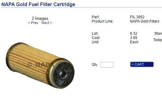

If this is the case, you can first install a checkvalve inlet filter, part number 3052 from NAPA (for the “long” filter, or 3051 for the “short” filter) and see if that cures the problem. If not, you can remove the clip from your needle so that it will drop down into the seat after engine shutdown to seal off the seat from the siphon action.

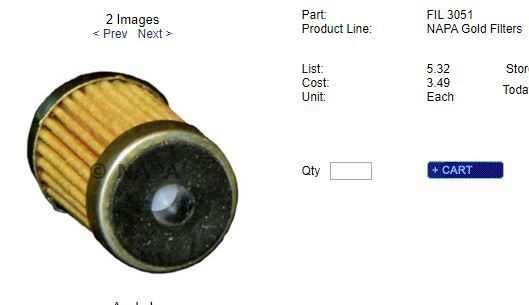

Lars,good read. I to have the QJ fuel drain-back problem. It seems the Napa-#3051&52 is paper element only,no check valve or gasket. Can the proper filt be ordered in a kit? Will the one-way valve hinder the fuel flow @ higher RPM on my 78' mostly stk L-82? Can the pressure valve sprg inside be modified. Changing out the f/pump would be my last resort. Hdal

Originally Posted by hdal
Lars,good read. I too have the QJ fuel drain-back problem. It seems the Napa-#3051&52 is paper element only,no check valve or gasket.
That's not correct. NAPA part numbers 3051 and 3052 are the part numbers for the NAPA Gold filters (i.e. Wix) with checkvalve:
The checkvalve does not impede high rpm fuel flow, but if you have a very weak pump (putting out less than 3psi), you can see fuel starvation under load.

Wow,I got skunked,the Napa-3052 one I bght did not have the rubber check valve. I'm pissed! Back to the store,20 miles away! I hoping the f/pump is good for 3-4 psi's,it has been replaced once yrs ago.Thanx for your input. Hdal
To Hard starting
