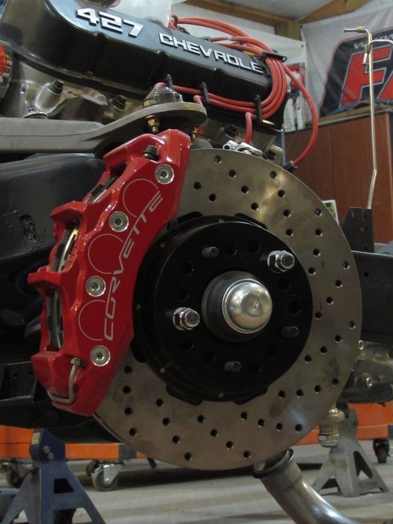

The original C3 braking system has several leaks and rusted solid parts. I want to replace everything with newer Vette parts even if that means paying for custom fabrication or getting bigger wheels to make more room for the rotors.

I'm using the stock C3 style master with C6 6 Piston Calipers up front and 4 Piston out back. No changes in any hard Lines.
