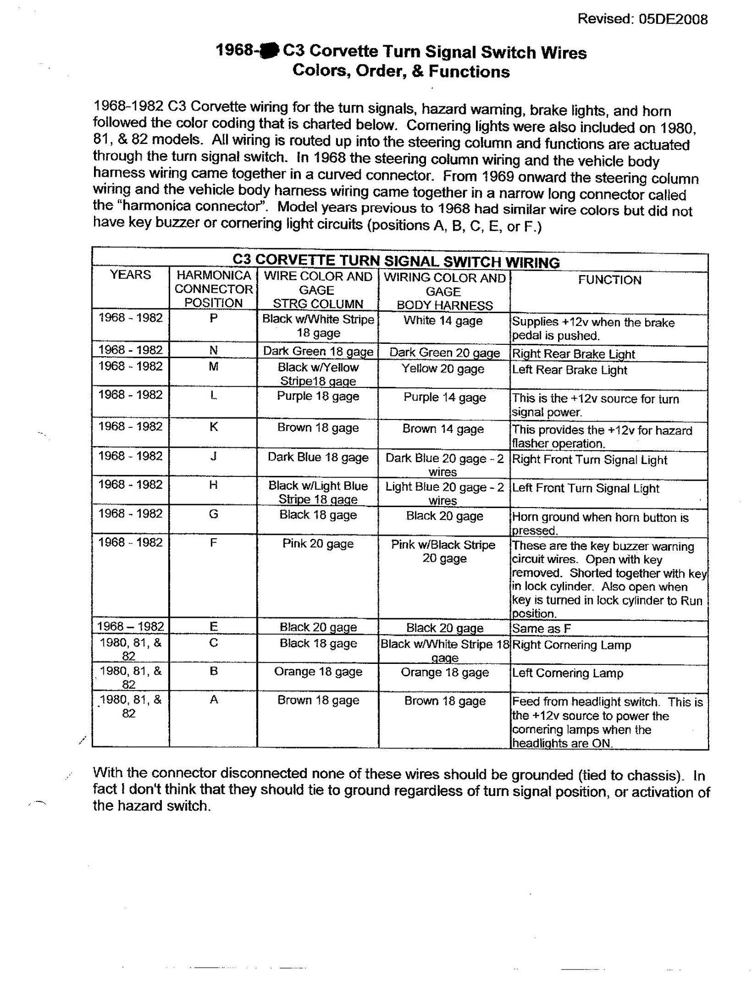

Disconnect the other end of the BLACK wire at 'G' on the harmonica connection which is at the bottom of the steering column.

I'm back again. What I thought was the horn relay was something else. After reading on, I located the relay, the light blue, square inch box that is tucked up near the fuses. Since I am 64 and not a contortionist, I am not able to reach that damn thing with two hands. I will attempt to disconnect the black wire at the base of the steering column. What does a harmonic connector look like? All I can find are pictures of harmonicas, which doesn't do me a lot of good. Please be gentle, I'm mechanically challenged and learning this stuff on the fly.

It's called the "harmonica connector" because it truly looks like a harmonica. It's long, flat and thin. Its clipped to the steering wheel column near the base on the right side. It's only slightly more easy to access than the horn relay

Check this link
http://jimshea.corvettefaq.com/wp-co...v27OC20102.pdf
