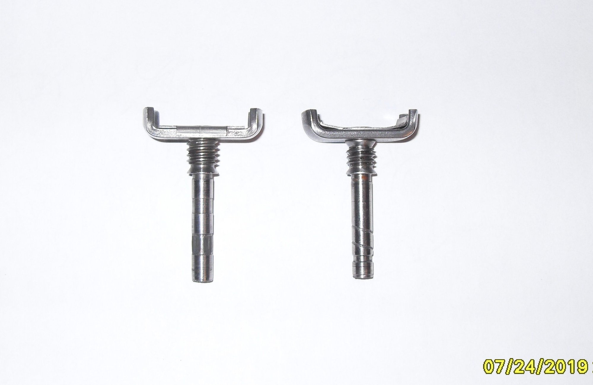

I was not able to find the "Magnet & First worm" gear. However the second worm gear is available from most Corvette parts places.
I was able to find a good used "Magnet & Worm". I appears that the design has not been changed for awhile, so good used ones should be available.
The used one (like new condition) came out of a 1943 Chevy Pickup speedometer. (The second worm was like new as well).
The magnet & worm on the left is 1943 Chev Pickup. The one on the right is my 1970 Corvette.
