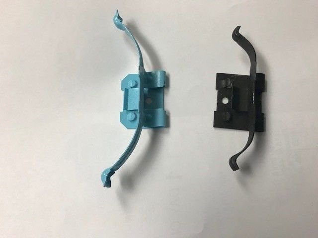

Well I finally got the new core in. Removing the old one from the box and installing the new one is a tight fit (PITA). I damaged the old retainer and could not locate the correct replacement. I did find 64-81 GM retainers at inline tube that worked fine with my core.

I used this
https://shop.docrebuild.com/1968-197...GM9985059.aspx
I was not overly impressed with it but I am happy with the results.
