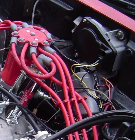

No need for one on my build and was curious if anyone has seen a plate to bolt over the cavity left by removing the washer pump. Would be easy to make but just wondering if one exists somewhere. Thanks!

The newer style plastic plate are frequently used. They are the same shape except out near the plug
near the top I show the difference between the plastic and the original
https://www.corvetteforum.com/forums...post1597666362
HIH
M

Wow, beautiful job Mooser! Thanks for steering me to the cover. Passed right over them in the catalogues.

I installed an electric washer pump in my '71 and used a '75 cover (I think that's the year GM went to the electric washer pump) on my wiper motor like shown above. There is a small part that needs to be cut off to make it fit but it's obvious when you go to fit it. Now if I can just get a wiper motor that is not a cheap-*** reproduction POS and work longer than 6 months.........
