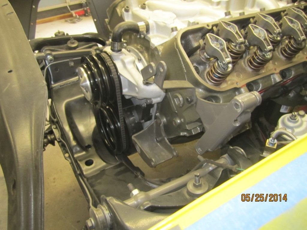

From a 72 but I believe your brackets are the same(?) Also ignore the CS144
M

Thank you. I think I got them figured out and I installed the driver’s manifold from below by removing the Z bar.
