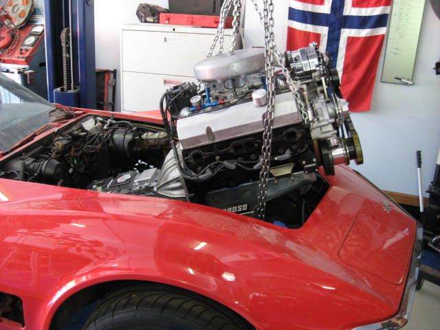

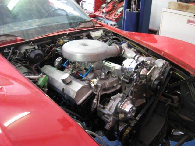

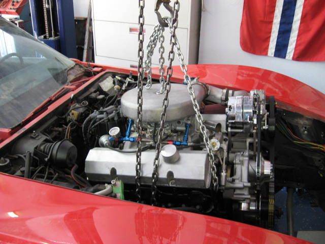

Also, if you're working on getting the clutch fork geometry correct (see my papers on the correct installed angle and geometry), having the entire engine/tranny assembly out of the car in one piece makes fit-up. checking, disassembly for correction, and re-assembly much easier. Pulling the engine/Tremec as an assembly and installing it as an assembly is the only way to do it, especially with a fixed crossmember. Pulling a Tremec out the bottom with the engine in the car is painful.
This isn't a big block, but installation and technique is exactly the same. Engine with Tremec (and supercharger) going in - piece of cake:
Floor jack was used under the tranny tailhousing to guide it up and over the fixed crossmember as the engine was dropped into position. Engine is in - 15 minutes total duration:
I've done several big block pulls/installations the same way, and it's the only way to do it.
