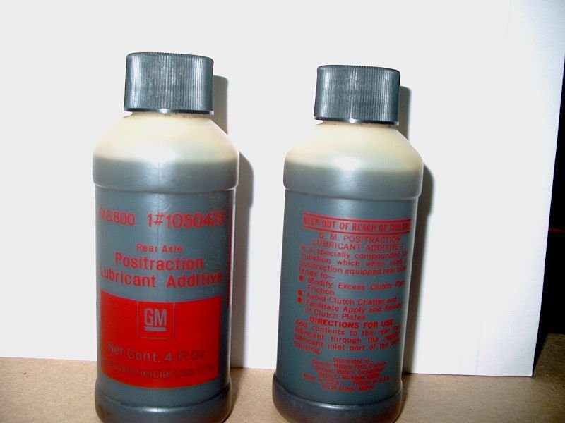

Last time i used 2 bottles of this, think i bought a box of 6 way back when.
