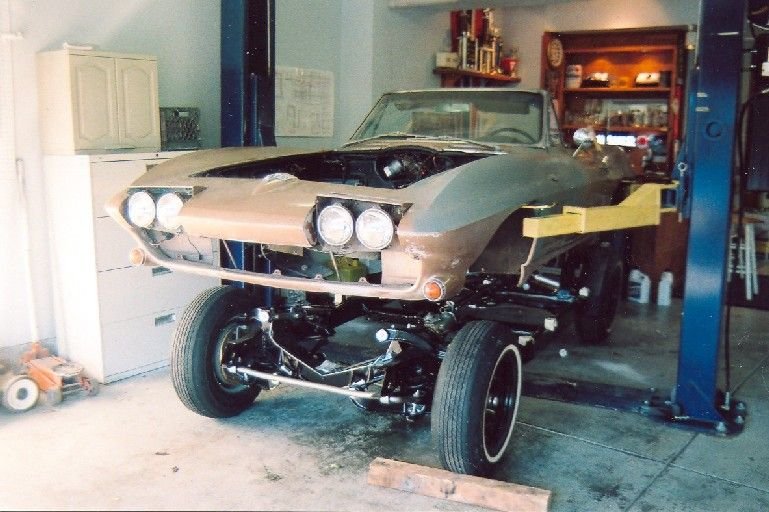

The body lift points were not the same as the jacking points for the car. The factory lifted and handled the body using some brackets that clipped into the tops of the wheel openings. I've used a 4-post to lift by the wheel wells openings without using brackets, and it works perfectly. On a convertible, you either have to have the doors installed and latched closed, or you have to weld or bolt stiffener bars in across the door opening, picking up the rear door jamb and the forward hinge attach points. If you don't, the body will break in half at the door openings.
