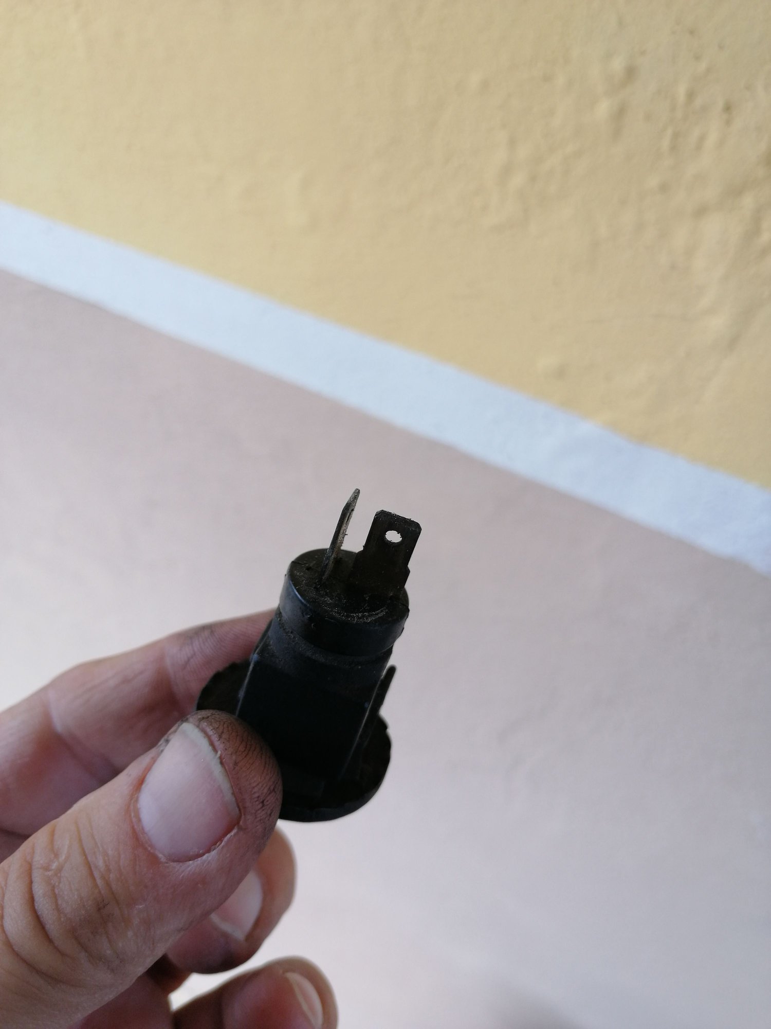

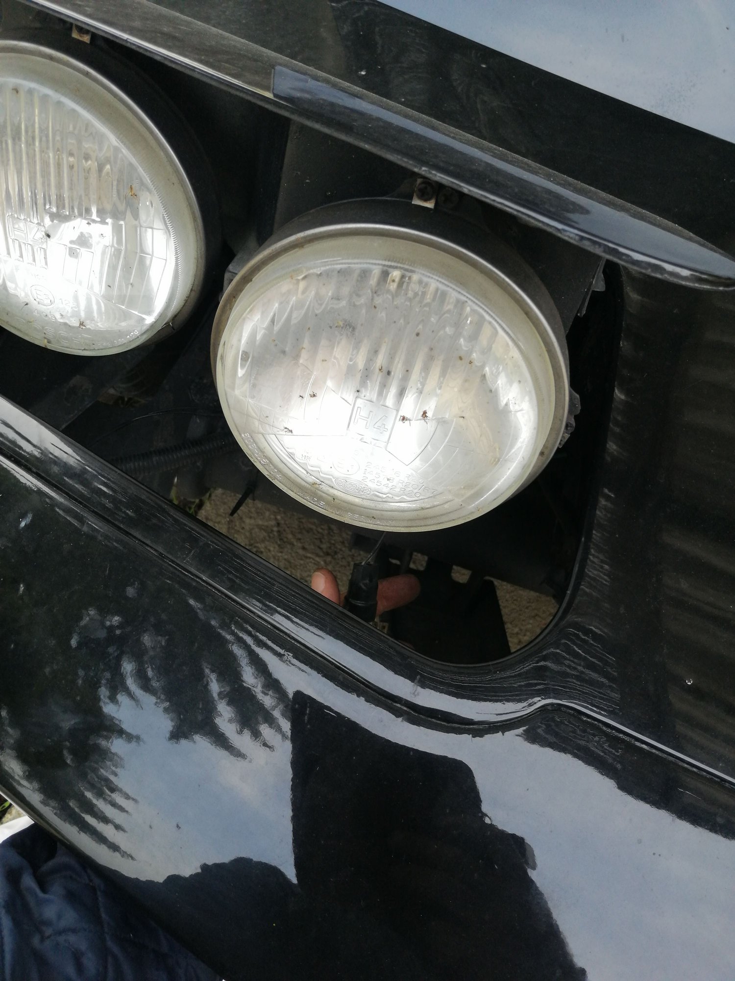

Good evening to all, I found this switch without support under the right car headlight of my Corvette C3 1976, I saw that pressing the black tire interrupts the contact, what is it? What is it for? Thanks a lot!

Headlight open position switch, turns on the red light on the dash that warns that the lights are on but not raised.
Frequently broken off

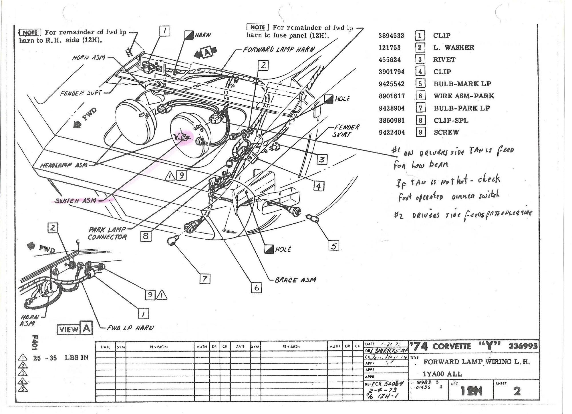

One switch for each side.
It goes here:
To Rubber Switch under headlight corvette c3 1976
