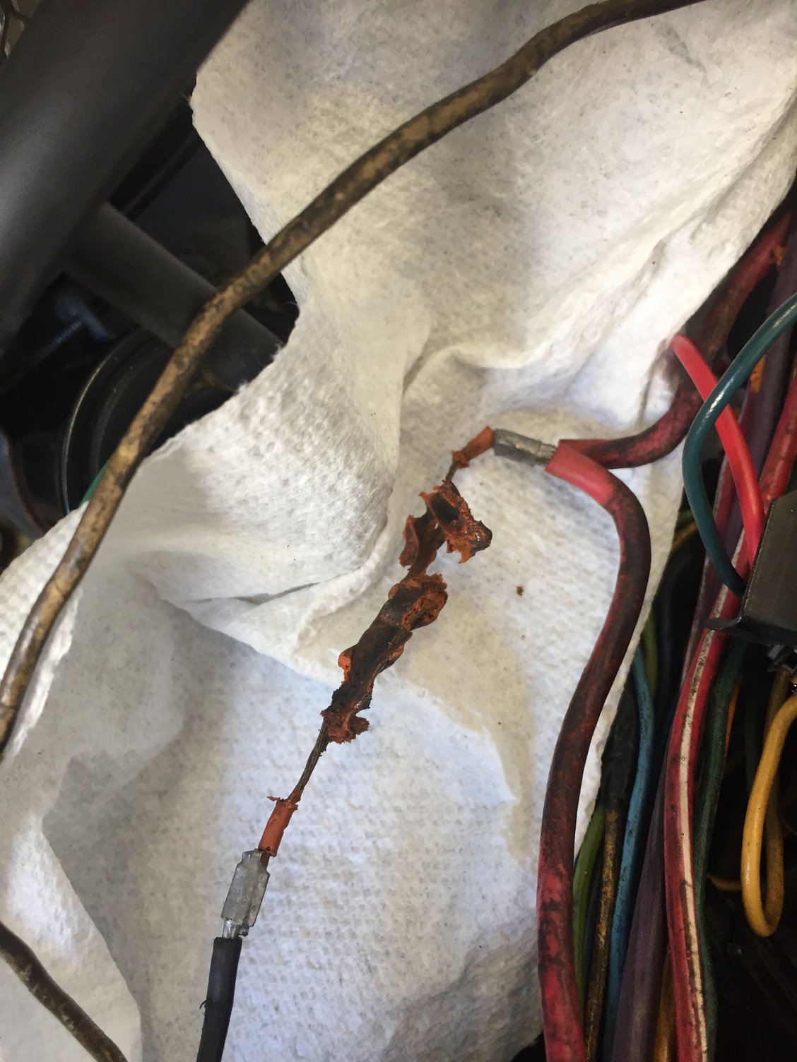

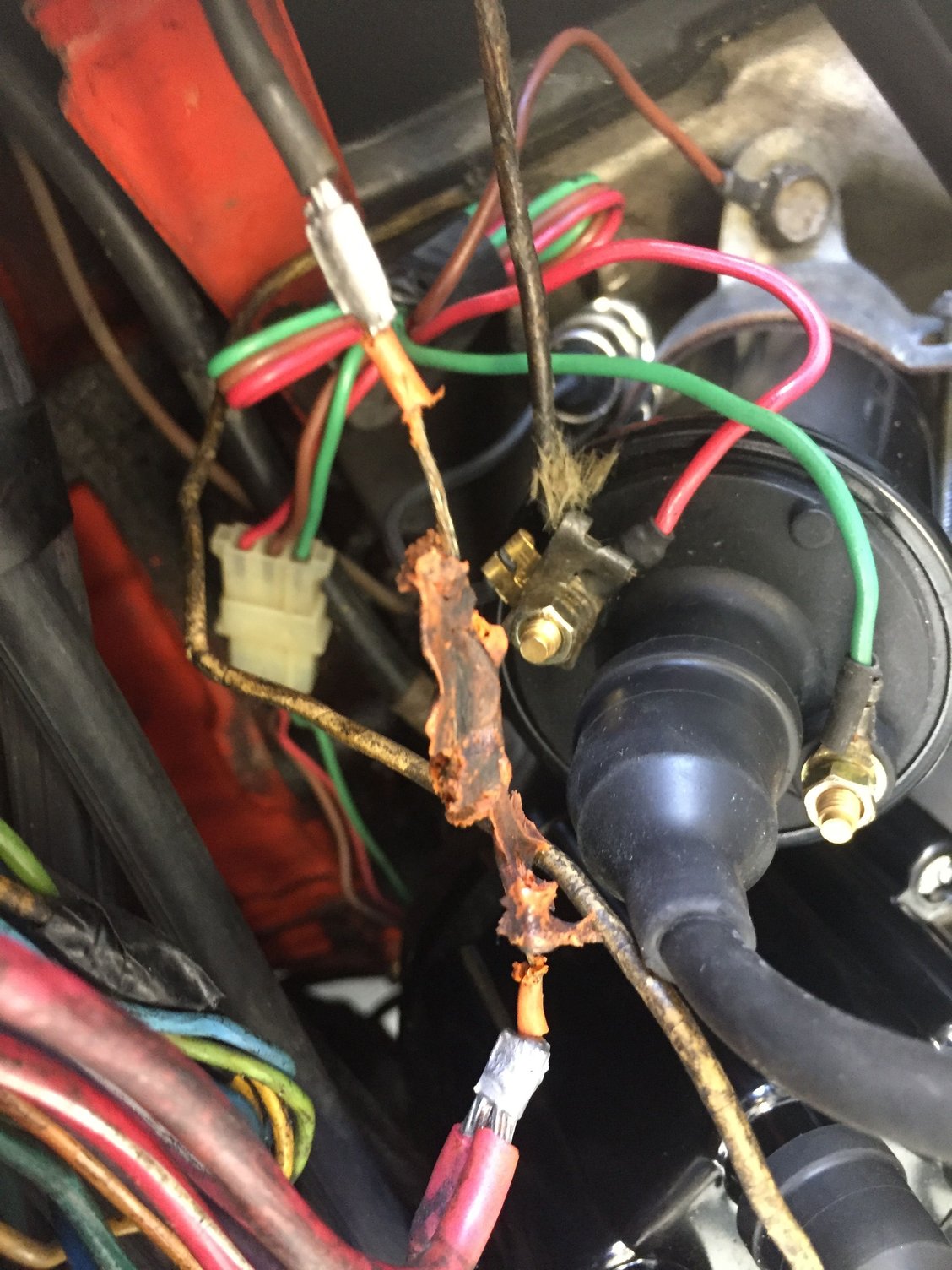

Well, well, well..... look what I discovered under wraps in my wiring harness, a burnt up fuseable link. I’m confident this is what’s causing my intermittent cut offs. Lucky find.
