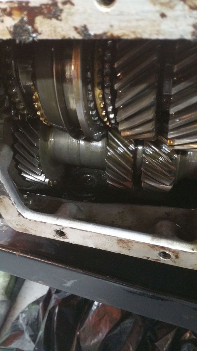

Its eay if it's out of the car. Pull off the side cover. Stuff a rag in there to contain the aluminium filings. Drill the hole then run the tap in half way. If you tap it to the top of the tap then the plug will go in too far and possibly not seal. While you're in there pop out the round magnet that's glued to the bottom of the case. When I touched mine it fell out. If it pops loose while you're driving bad things happen.
Then make sure the new plug has a magnet built into it.

If you look in the bottom of the case you can see the donut magnet

I also have a B&W 4-speed with a drain plug . If you want to drill and tap a hole, I think you'd want to remove the side panel first, at which point you wouldn't need to drill and tap a hole.
