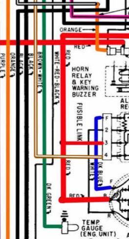

It's a DARK GREEN lead. The sensor is grounded to the block. It is a single connector on the green lead and plugs right onto the temp sensor electrical end.
See below:

Look at the picture in this link of a 68 engine, you can see the green wire going to the cylinder head
https://www.corvetteforum.com/forums...ve-covers.html
