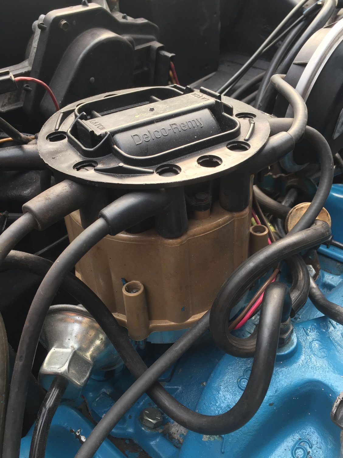

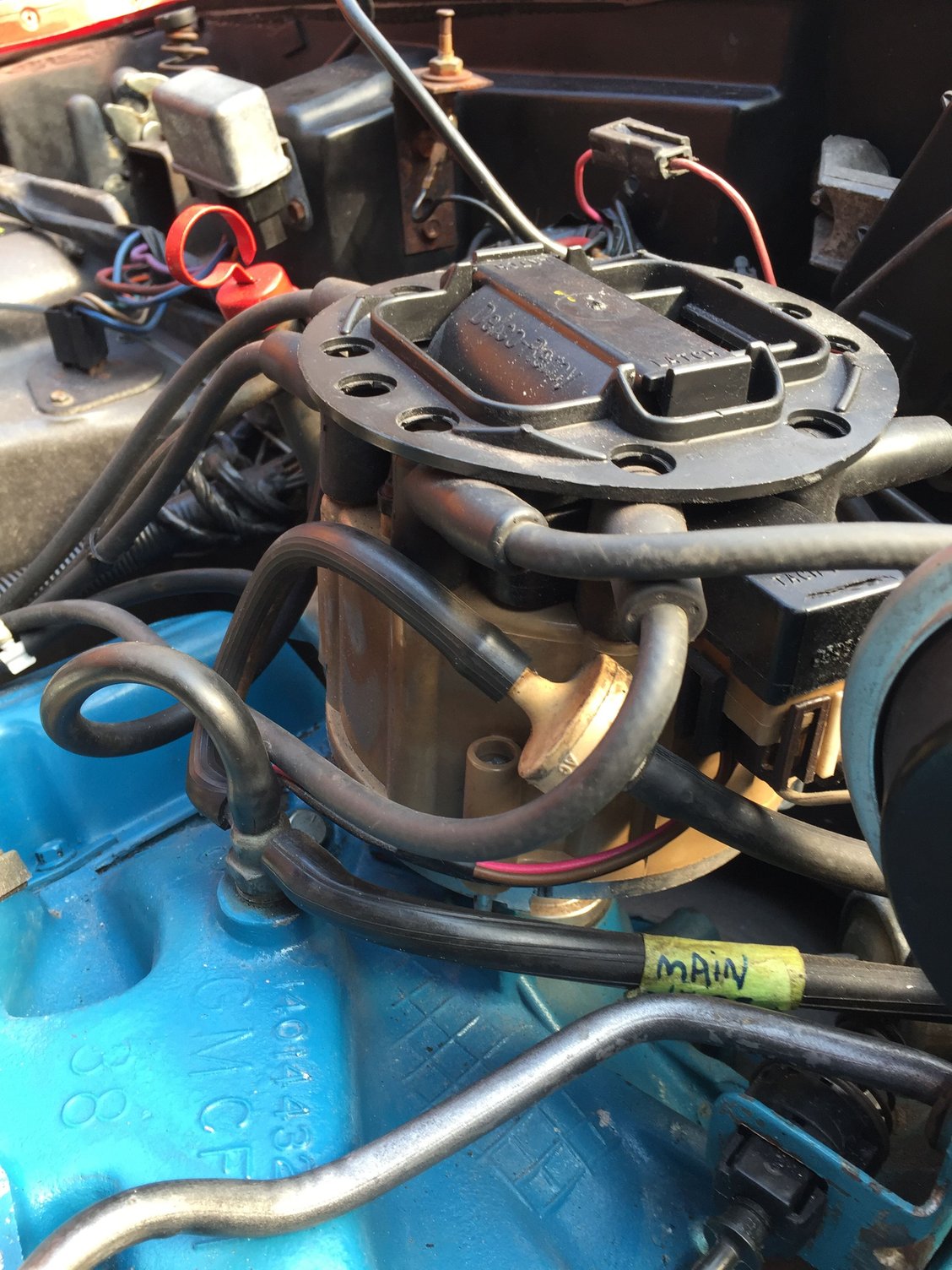

Can you also post a pic of the distributor. I'm thinking that they replaced the distributor with one that doesn't use the ECM and has vacuum advance.
I would look for a non ECM quadrajet carb from someone on this site that you can setup correctly. If Lars could sell you one, I believe his sets them up on a motor before shipment.

Hi Dave, this is the dissy that's currently on it!..I'm in Essex, 50 miles NE of London.

Looks like the distributor on the car doesn't have a vacuum advance. If this is the case then the distributor on the car is made to work with the ECM also.
If you're going to go the route of non ECM (recommended) unless you do a full after market fuel injection like the Holley Sniper you have to consider there things.
Carb - replace with a pre 81 carb (80 350 engine vettes did not have the ECM). I prefer the Rochester as it can be tuned for the car, fits the air cleaner. Cliff Ruggles at Cliffs Performance can supply tuning parts and I believe Lars on here can also but would need to confirm.
Distributor - Need a pre 80 HEI distributor with the older module and vacuum advance
Transmission - If the car has a turbo 350C which includes a lockup converter offered on 80 and up cars to gain a bit extra mileage. The ECM controls this on your car. You can disable this or find the parts from a non ECM 80 carif you wnat to keep. On my 80 L82 I removed the pan and removed the lockup solenoid when changing the filter. I have since installed a 5 speed.

not sure which the distributor is but it does has vacuum advance.
I've fitted the fresh carb, so it's on and the car started first time after about 5 seconds of cranking. Seems to idle well, certainly better than the old one, and revs. Just need to sort out the electric choke keylive feed.

OK now see the distributor was swapped. Looks like you're well on your way.
The car may have the 350C trans with lockup disabled or they also put in a non lockup turbo 350 trans. They are the same 3 speed auto except for the lock up of the converter so no worries.

It looks like you have an adjustable vacuum advance, possibly an Accel 31035. See if you an find a part number on the advance can, and the directions online. If you haven't already, email @lars for his timing papers. With a hand vacuum pump and a dial-back timing light, and perhaps some advance springs, you should be able to tune your ignition pretty well.
