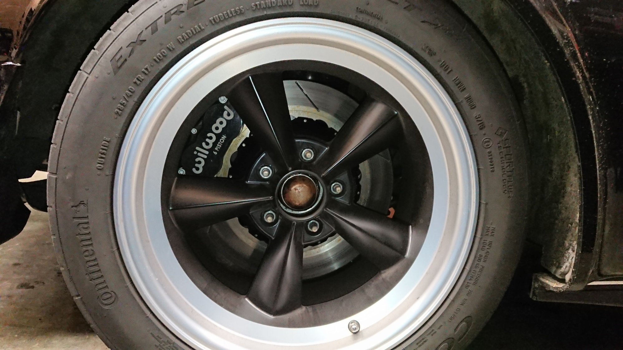

I have the Wilwood 6 piston 14" fronts on my car (140-10617). Absolutely love them. With H pads, they work great on the track even with no ducting, pull the car up very quickly lap after lap and still work good when cold. Lots of dust and rotor wear though. I am running manual brakes, dual master cylinders with a balance bar. I would cook the factory front brakes within a couple of laps. They recommend minimum 18" wheels but they actually fit under my street 17" wheels too, so it really depends on wheel design and you'll have to measure against your wheels to know for sure.

Under my 17"s:
