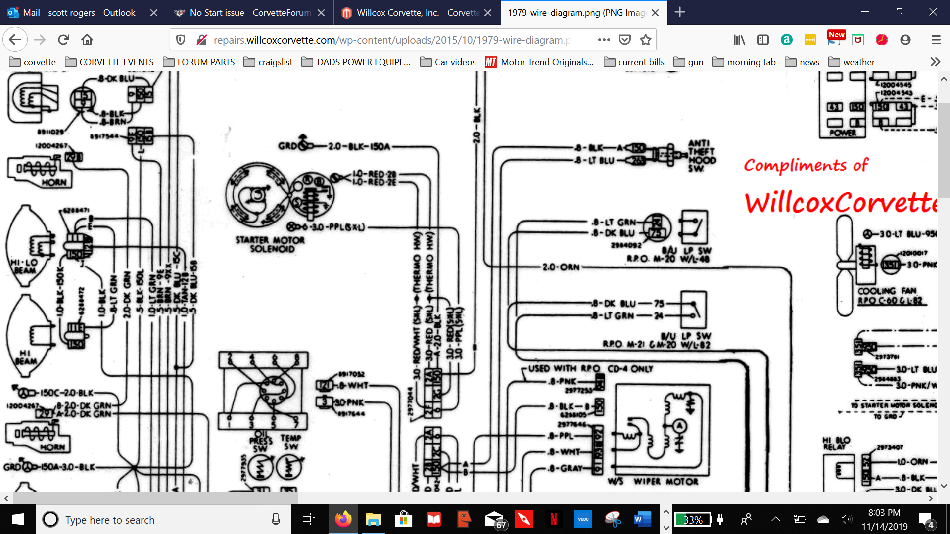

Might be a few things:
Neutral safety switch might be out of adjustment, move the shifter back and forth in 'P' and 'N'.
With the key in 'START" check for 12 volts on the 'S' terminal of the starter solenoid.
https://docs.google.com/viewer?a=v&p...TYyNWViMWY1NzY

my first guess is its wired wrong as peterbuilt thinks. If it is a fuse you can use his pic for figuring out if your getting power. Pick up a remote starter testing tool. It is just a handle with a momentary switch that you hook up from the S to main lug. When you push the trigger it acts like your ignition switch. If that works check your nuetral saftey switch by trying to start in nuetral vs park. If its a manual check the clutch saftey switch if it has one

Now, if we can just get Mr. Peterbuilt (post 2) to tell us what color wire goes where . . . . . . . .

looks like red on the top and purple on S any other wires you got there? Do yo have a meter to make sure you have power?

Rescue Rogers got it right!
HariedDriver:
At the starter jumper from the top large red to the purple on the small inside terminal to see in the starter cranks.
If YES then turn the key to START and see if you have 12 volts on the purple wire.
Post the results and we can go from there.
Do you have a meter or a test light?

Appreciate, all the help, I didn't have the diagram above at the time, I wish I did! Where the car was stored , I had no cell phone service!
