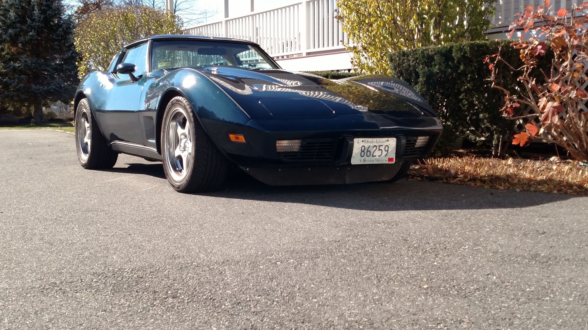

360 VBP Composite on the car since 1986, Bilstein Sports rear only, competition adjustable heim jointed struts, OEM GM bolts on the spring with poly cushions-REAR
550 front Coils 1 inch shorter than stock, Bilstein HD's Front Only-FRONT
Engine^^^^ is OEM L-82 block rebuilt 355. Aluminum Stewart water pump. Dewitts aluminum Radiator, no emissions gear including AIR pump and plumbing, Holley Aluminum 4175, Aluminum L-82 intake manifold, In this picture only, shorty headers (currently 1 3/4 long tube stainless steel headers), AFR Aluminum cylinder heads, and a few other Front end weight savings measures.......just to give full context to stance....
