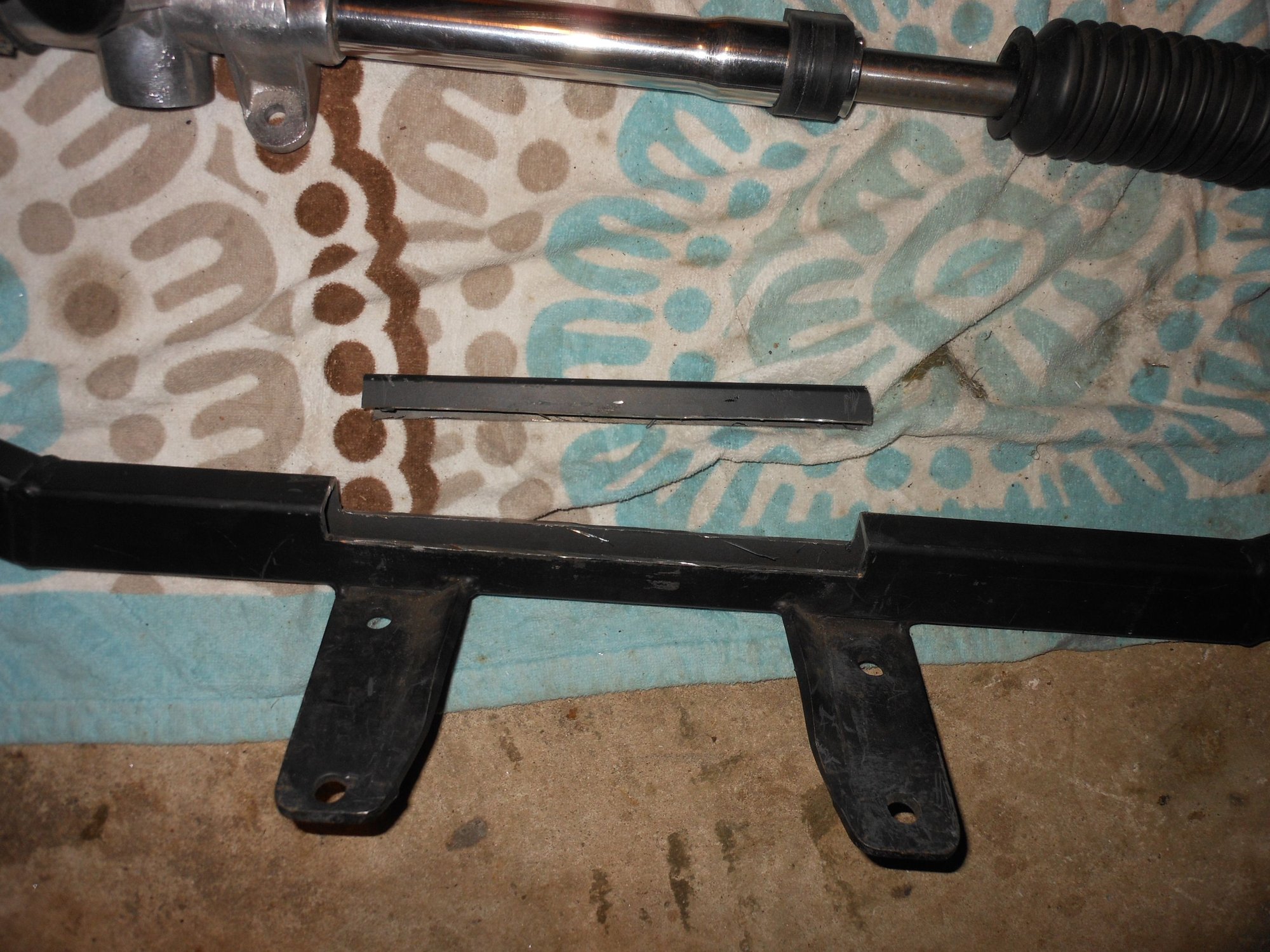

I went with the Flaming River Manual version. I bought it from an guy who was selling off his project- and was able to get it for less than half the price- missing a few bolts.
I would have a tought time paying retail ($1400+) as it required some redoing the mounting point- beefing up the frame with tube to keep from crushing the frame- and I used better bolts ( button head to fit flush better)
The cradle was really nice- the rack and pinion was really nice...but required to much fab work on my end to warrant the retail price point. I do have a "non- stock" engine - so I had to cut the cradle and redo a part of it...
Rather than drill a hole through the motor mount as the kit said to do- I notched it and used two sets of u-joints versus one.
I would use the piece again- BUT wouldn't pay full retail for it!!!
For the power part- I added a Nissan Electric power steering motor- and the set up feels great!!!

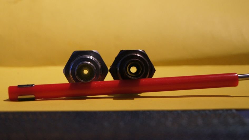

This Flaming river kit requires less flow & pressure from the Power Steering Pump (standard GM pump) or you get too much power assist which drives like a over assisted power steering. Most noticeable on highway driving light twitchy feeling. This is solved but adding a flow restrictor to your Power Steering.
Here is a picture of the factory vs the new flow restrictor.
The ideal setup would be a variable flow power steering pump. This unit I got from TurnOne
https://www.turnone-steering.com/col...low-restrictor

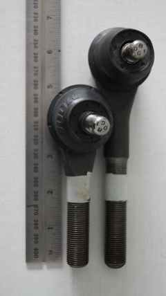

Here is what is a problem with the cradle. The (mustang rack flaming river) unit is not mounted centered in the frame. This is due to get the rack needs clearance from other items to allow for steering connections. What does this mean,
The driver side tie rod link is closer to the tie rod vs the passenger side. At first you think this is not a big deal, BUT IT IS.
Flaming Rivers response:
Center the steering unit there is equal distance both sides.
But if you do this it will reduce the full lock to lock turning radius, and for me this was a big change. This was about 3/4 steering wheel turn in one direction. So a total of 1.5 steering wheel turn.
To fix this is also a simple change. The driver side uses the factory Tie rod end moog ES323 , and the passenger side uses a tie rod from a 1969 Camaro ES381R
Again a simple fix. You can now center the steering rack and get the maximum turning radius of the rack.

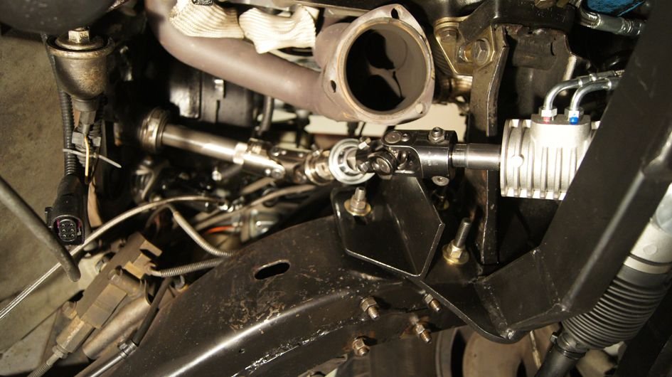

The connection from the rack to the steering column is the biggest problem. You will have 3 problems.
1. The d shaped keyed joints for the connections don't align the steering wheel properly so the return direction signal mechanisms don't work anymore. To fix this you would need to make a new keyed point on the steering column. (this is not easily resolved). Of course you can always set the steering wheel centered (reduced turning radius problem of non centered rack)
2. Angles for the joints may be more than the joint allows for ( binding or stiffness while turning ) This requires shortening of the steering column. I was able to get this to work without shortening the steering column, its not perfect but I was ok with some variable stiffness while turning.
3. You will need to fabricate a support bracket for the connection rod from the rack to the steering column. Supplied one doesn't work well.

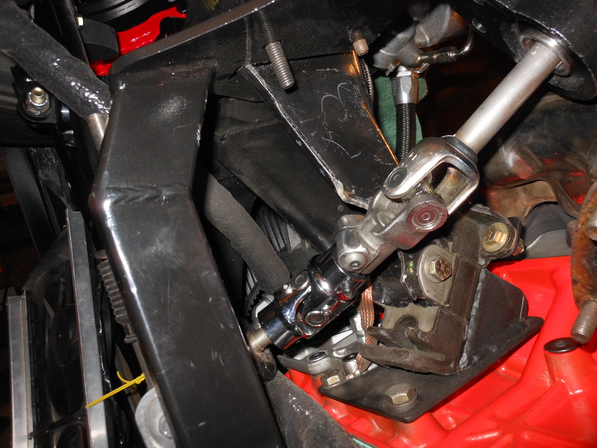

I made this to use the factory frame holes from the steering box.
Also the shaft connecting the 2 joints will need to be shortened to your requirements to get the best angles of the joints. This will take time to get the best smooth operation.
Here is what it looks like from the driver side frame.
The main reason I made a change is because the factory parts / aftermarket parts don't take the abuse of track days, mainly around the issues about leaks.
borgeson steering box can also be an option, but you will need to make sure you have room to install.
As far as how it drives, its a great improvement vs the factory setup, but at a cost. For basic street driving you can do better with other options.
