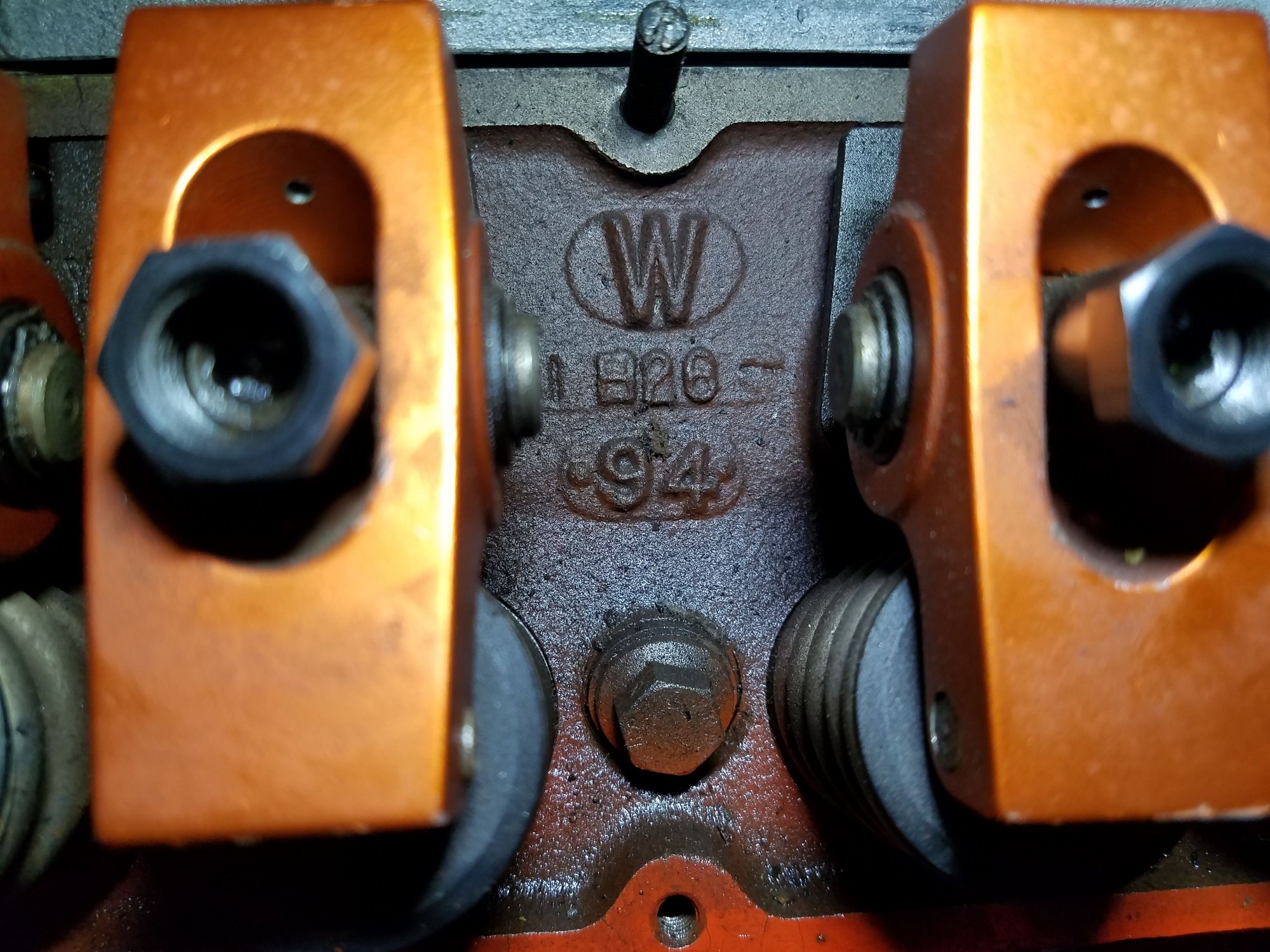

Now that I have the Vette running and driving – I went and bought another project – 72 Nova – Driver quality paint and just a motor and trans in the car. My question - it is a small block 400 and I can’t seem to track down what the heads are. Hope someone can help.

Best guess ... World Products

so thats proly what the W is - Thank you for the quick answer - doing research now.

WP ... Sportsman II
Get ALL your numbers together and call WP ... they can tell you for sure and maybe chamber size too.
I bought a 377 (400 w/ 350 crank) race motor w/ Sport2s ... I called WP and they helped fully ID 'em.
Those were good heads back then and they still are.

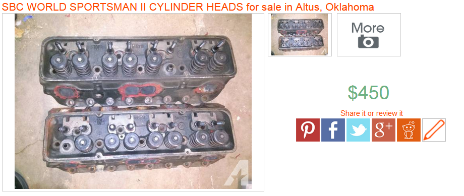

From what I can see, I believe they are Sportsman II's as well. The exhuast port looks too big to be an S/R Torquer and these appear to be pre-2005.
I used to work there for a spell A quick search found this picture above.
These heads were a staple in the Hot Rod community for years.......not state of the art but work very well and are bulletproof.

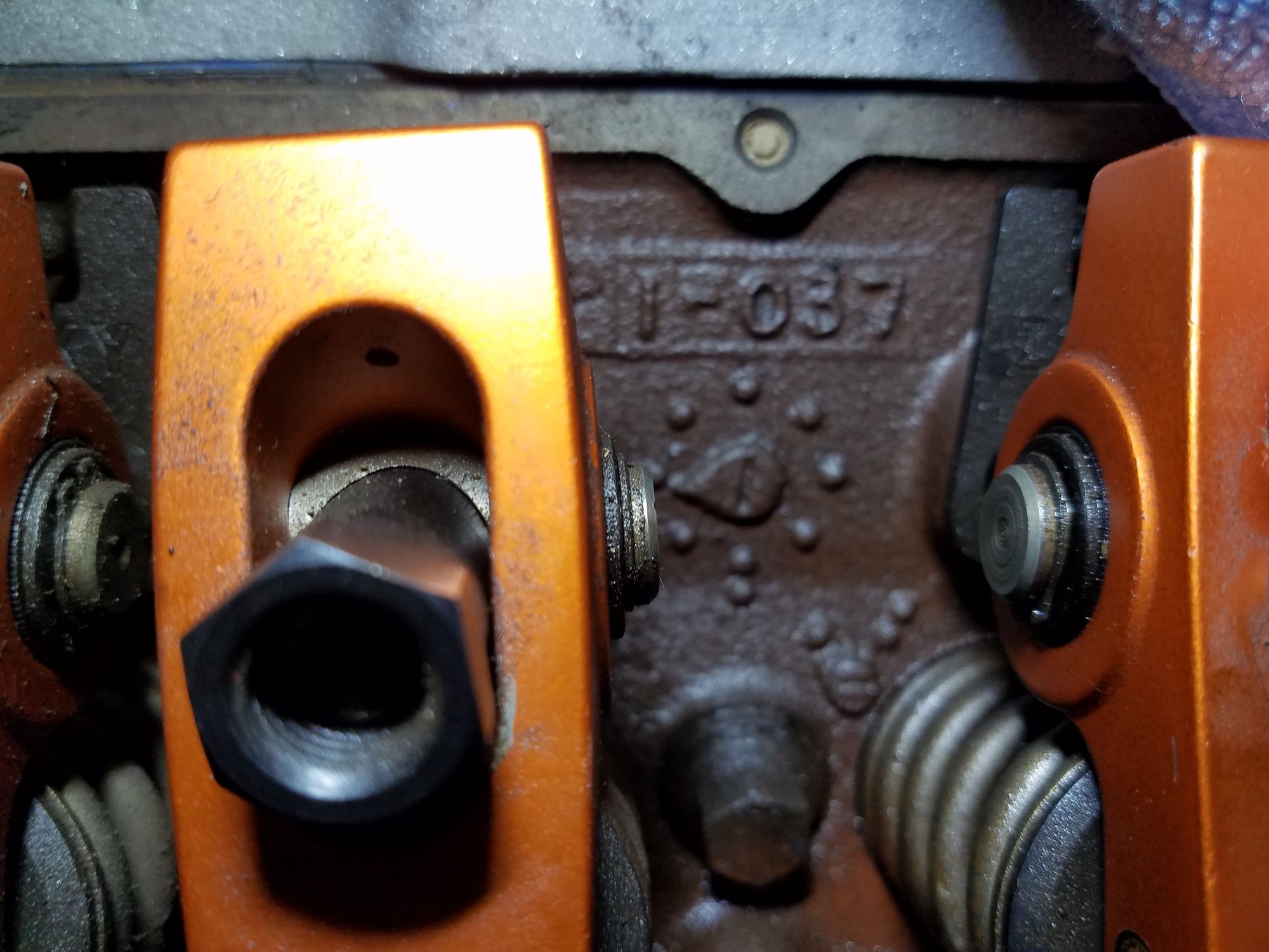

/ link # 1 (OP's pic of his head)
/ link # 2 ... Seems I-037 ... IS a Sportsman II w/ 200cc intake port runner ... BUT ... w/ EITHER 50cc OR 64cc OR 72cc chamber ...
... if you can resolve the Part Number, you might also ID chamber etc using ID pdf With Catalog link # 3.
/ link # 3 ... Seems they're still available and USA made; which surprises me, but not nearly so much as the unarmed one's concurrence.
As before, call WP (maybe it's PBM these days) & perhaps they can further ID chamber etc.
