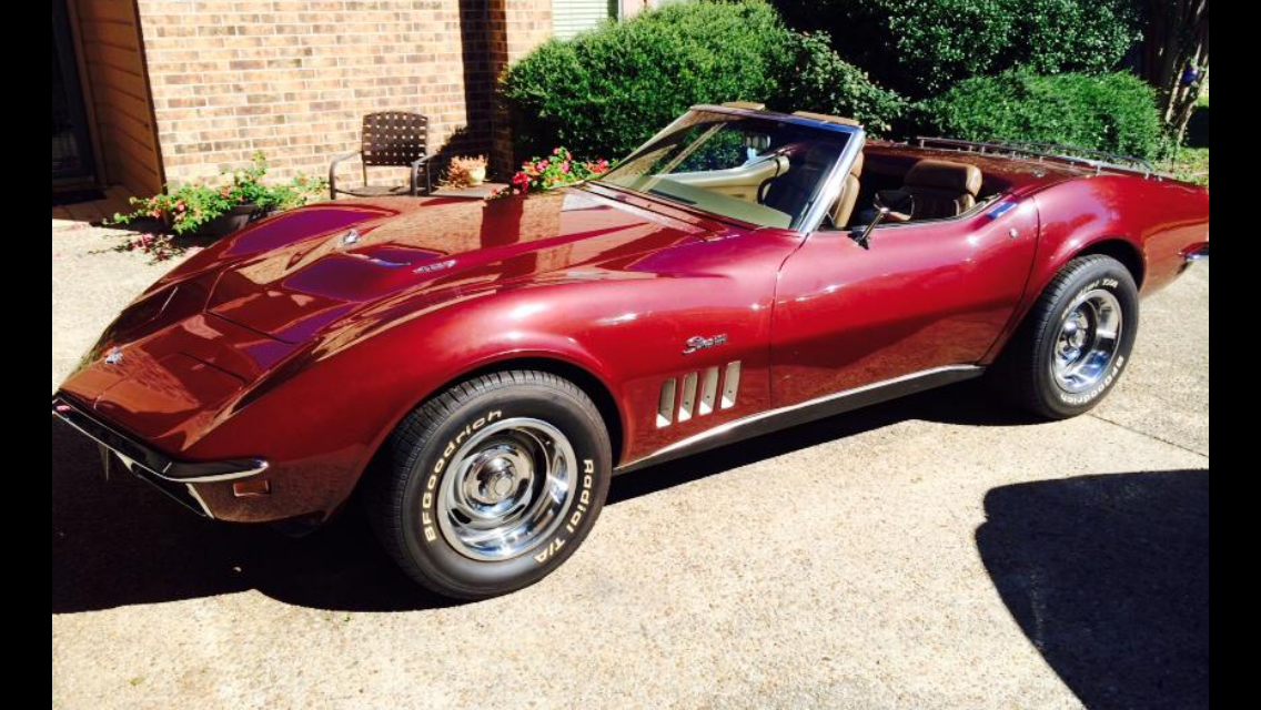

Such an awesome retro setup.......exactly how I would do it......all of the power with none of the loss of what it is (L-71)......it is an "enhanced" setup......so sneaky.
You could win a lot of street races with this! LOL!
I think I would have 255/60/15 BFG's all around......I loved them on my 427/400....flat caps for the win too.....lots of grip for shannigan's as they were so wide......went Bilstien shocks here and urethane sway bar links......you would never know it had a big block with A/C in it unless you were going WAY too fast......

Jebby, yes beautiful. Checked all the boxes with that car: Tri-Power, AC, Vert. Don't know if I've ever seen a Shark with all three.
