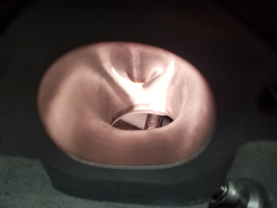

Sell the irons get some AFR 290 or 265 and dont look back. Dont sink money into old iron heads. They guys that can make em hum..youll spend almost as much as the good stuff trust me. Upgrade that intake too. You can always grind off a mfr and paint it. who cares anyway?
pm Jim aka tpi421vette for a good deal on a new set cheaper than Summit. Just ported a new set real happy with em. All done for less than this guy coulda bought them for.
Almost noone ever puts old stock stuff back on and if they did youll be in the ground.

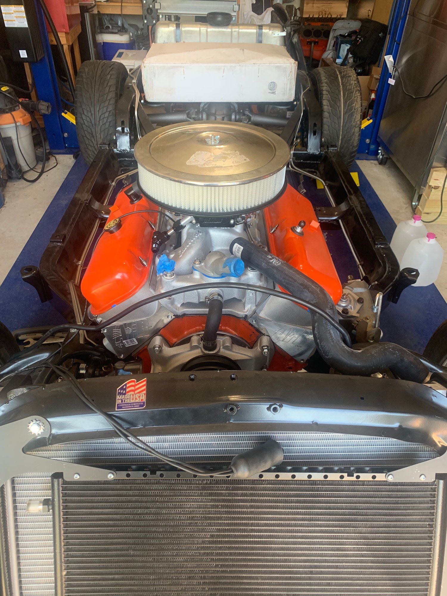

I started with the same combo as you (68 L71), I did the afr 265's and straub hyd. roller (my Vac stuff works, but it ain't 14" at idle). I kept my tri power and didn't port match, I have 560hp corrected with the Air Cleaner on. You will need headers and free flowing (somewhat loud) exhaust to realize the gains tho.
As far as performance, I have run an 11.90 1/4 with crappy tires and a rolling start (I'm fighting a fuel pressure loss during 2nd 3rd and 4th due to old rubber hose splices). I expect to see low 11's next year after a plumbing upgrade (thanks Jebby for the post of the Fuel Pickup).
Mark Jones (vortec pro) can do some pretty amazing stuff with the iron heads, I'd go that route if my car was numbers matching. (any nay sayers can check AJ's performance stats)

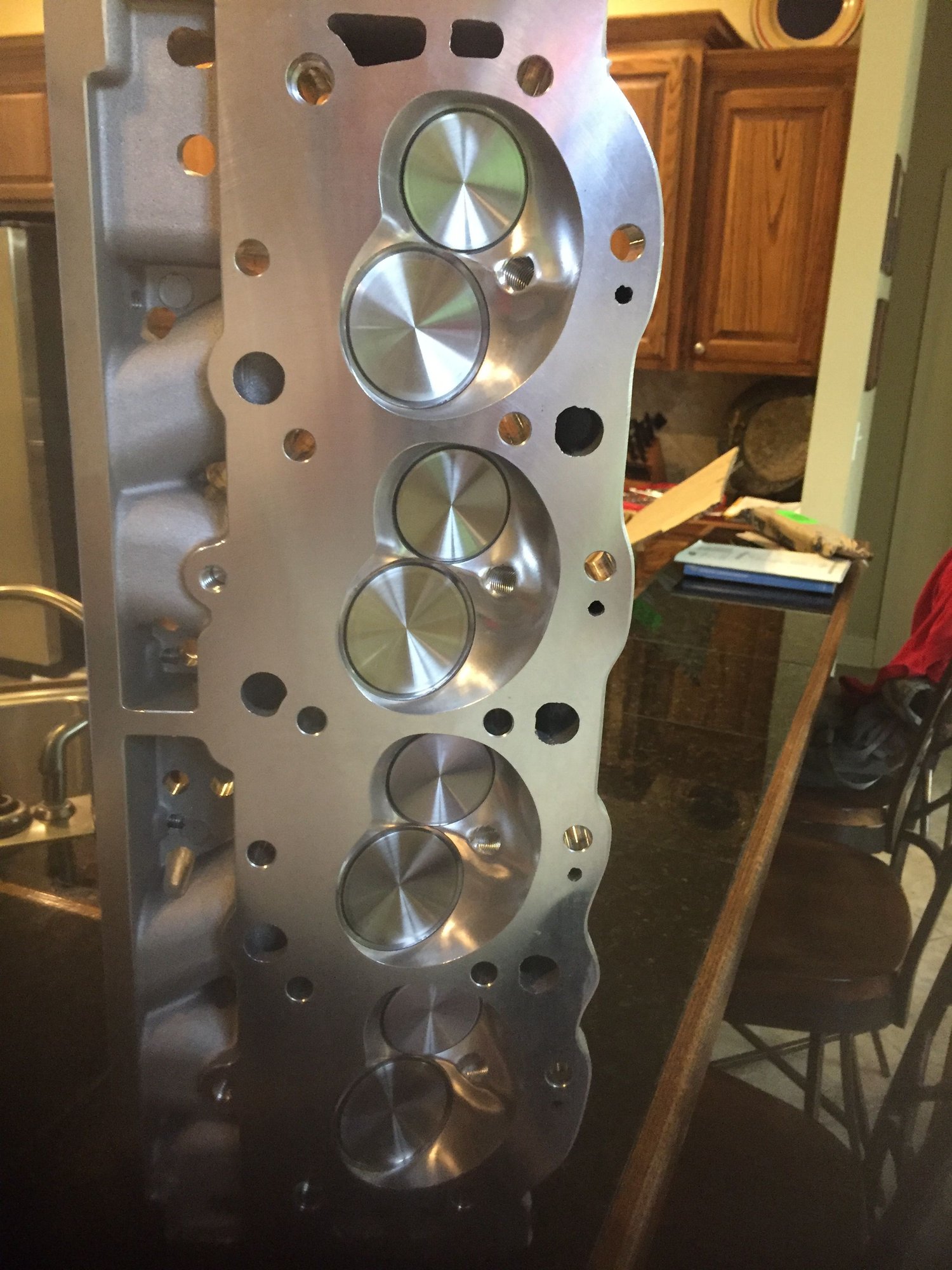

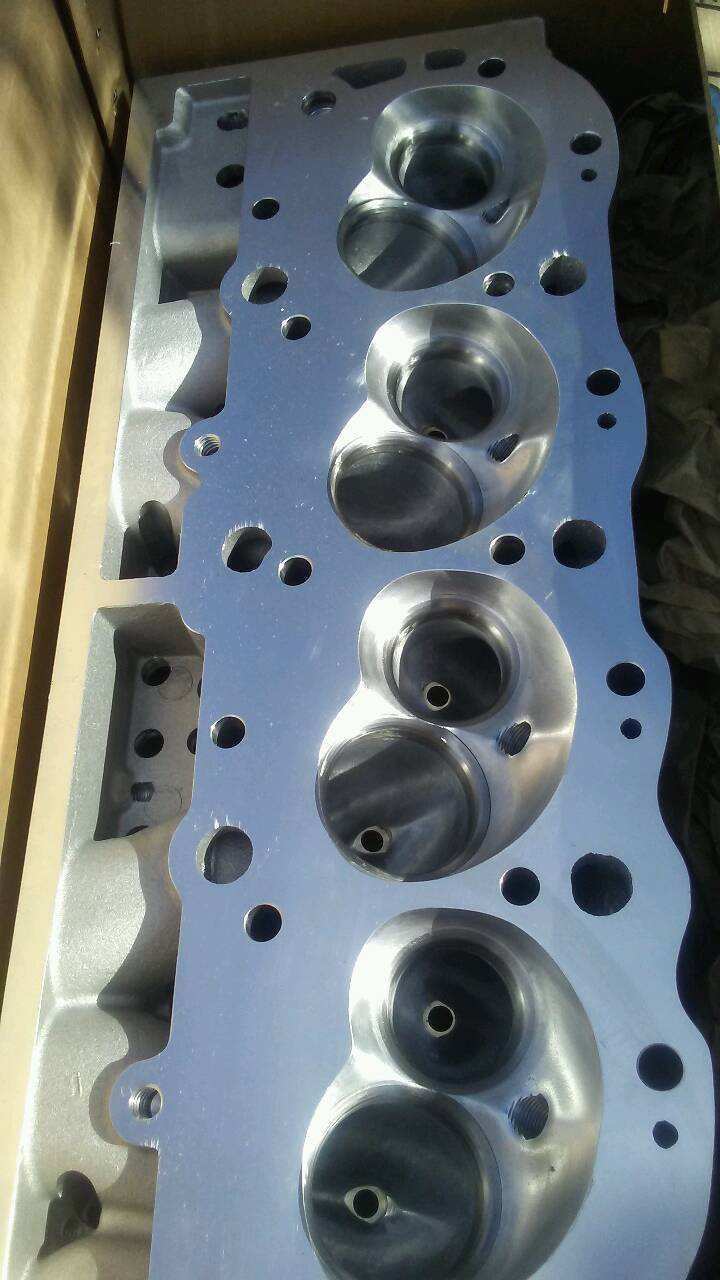

mark knows his stuff. Id still go afr heads get a cam from him
They are just so much better cant deny it.
These are going on a 31 panel that already pulls the front wheels up with stock 049s. Right cam worked over tunnel ram stall its going to be nuts.
Good airspeed flow craploads of air.
page Jim aka tpi421vette in the c4 tech section. My friend paid summits price for these setup and ported for his at the end of the day.
