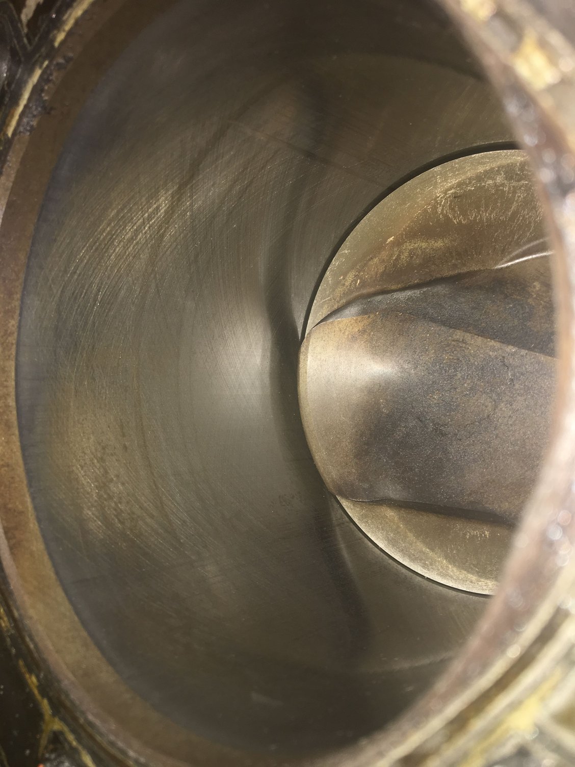

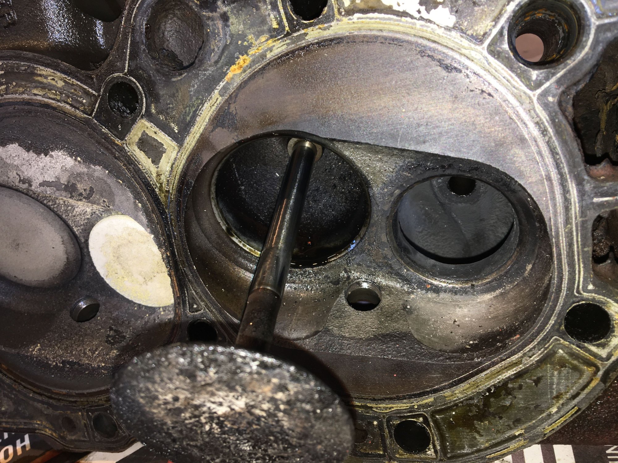

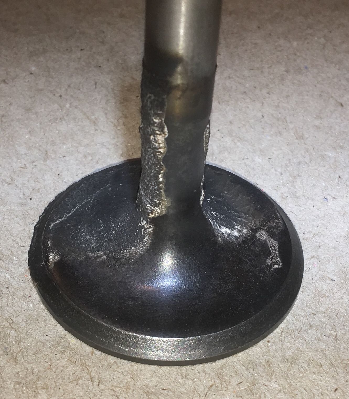

Ok, update. I cut open the oil filter and unfortunately found "gold"....bearing material. Motor pulled and disassembly / inspection now in progress. Here are some photos and I'd really appreciate your expert comments regarding condition, wear, and way-forward recommendations. Thank you advance.

Cylinder honing marks look terrific! Low wear here.
Deposits on valves look normal. Like you said, loose guides, using oil, smoking. etc. Use bronze liners on the guides, not whole new guides.
Pocket porting the heads is a great idea. So is a good cleanout and new bearings.

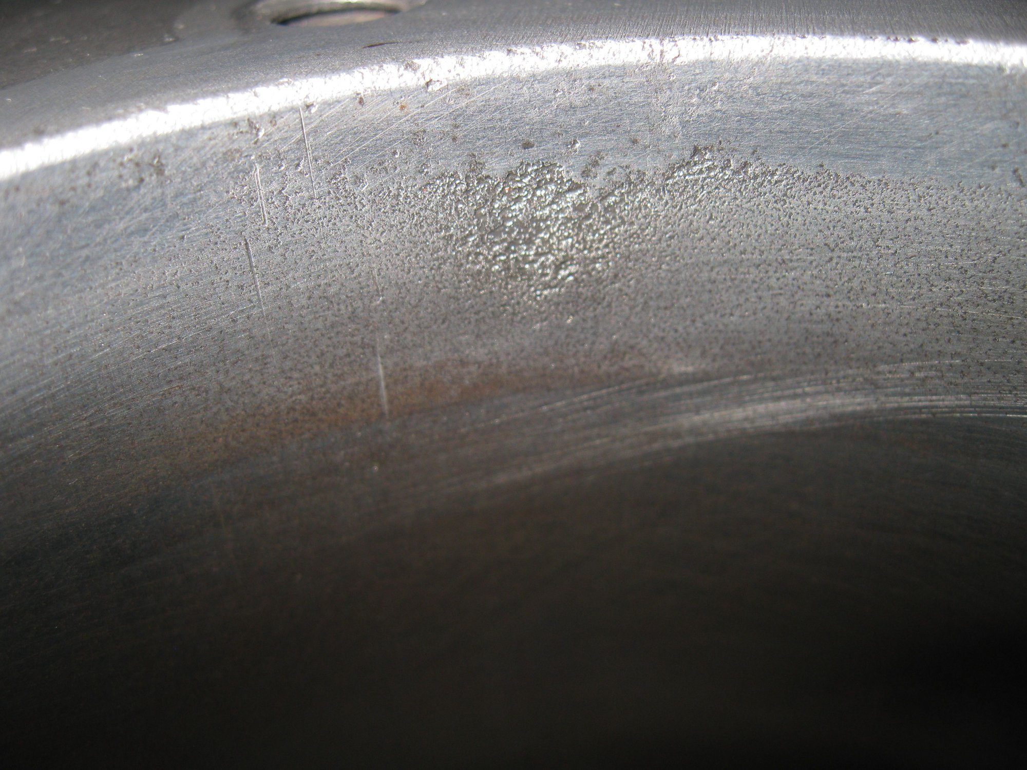

Here's a photo of the worst cylinder bore. I was hoping a hone will clean it up versus a bore job so I can reuse the original pistons. Thoughts? Thanks, Chris

That is not going to clean up completely with a "ten pass" hone. It really depends on where the top ring end up at TDC.......measure the ring land from the piston deck.......see how far the piston is down the bore at TDC......do the math to see where you are at.

Well the rough surface is just below the compression ring at TDC, so I presume that's a bad thing and will need a bore job. What do you guts think of the these HR cams specs using stock compression ratio (stock pistons & heads).
