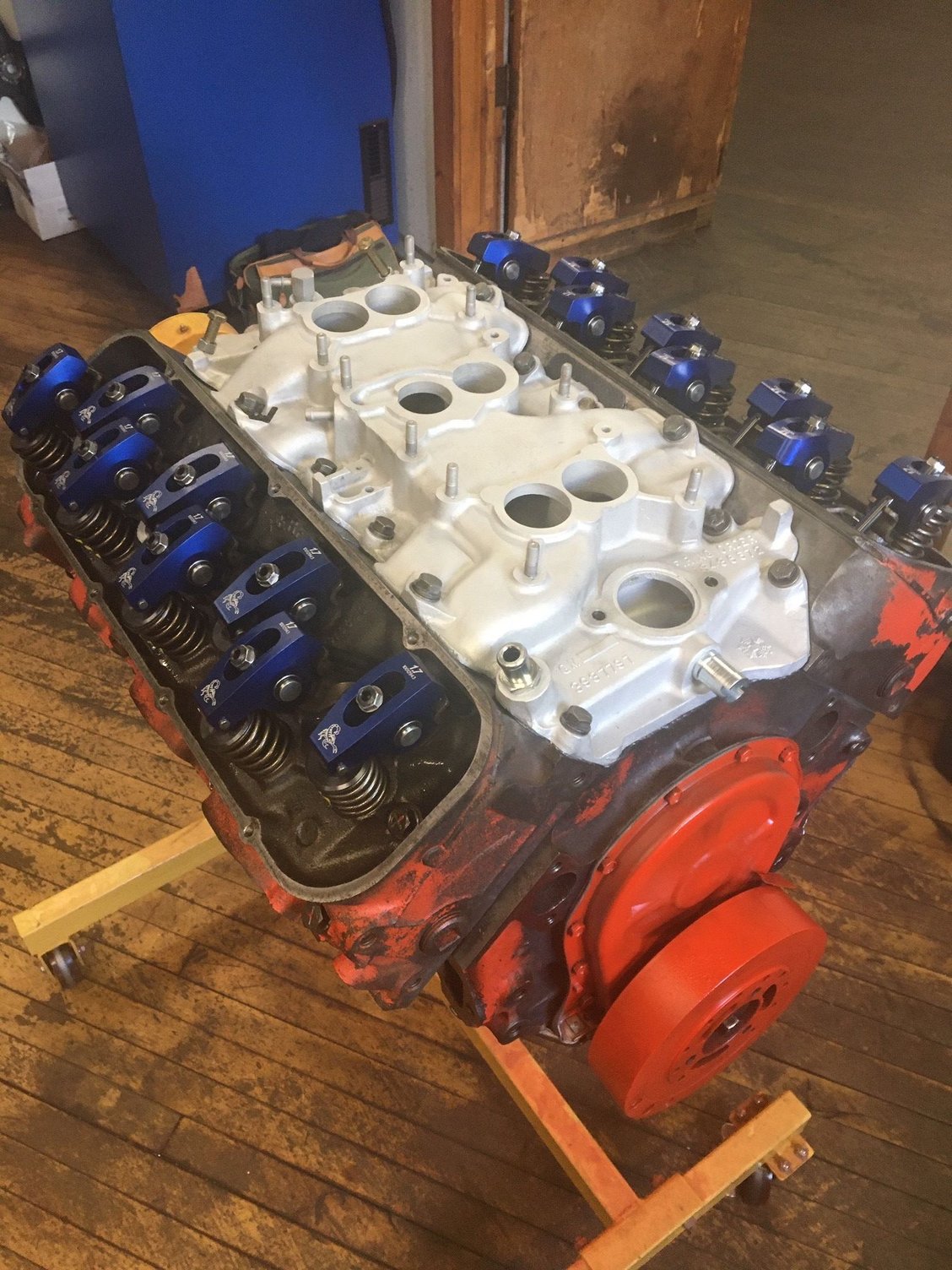

Thank you everyone for your insight and thoughts. This was a long journey but ultimately a very rewarding one. The dyno was optional but I'm so glad I did it. Doing multiple pulls we were able to optimize the ignition curve and air/fuel ratio. There is nothing quite like the feeling when watching your rebuilt motor firing up for the first time in 18 months. And to then hear it scream.....
More build pics because who doesn't like build pics...………..

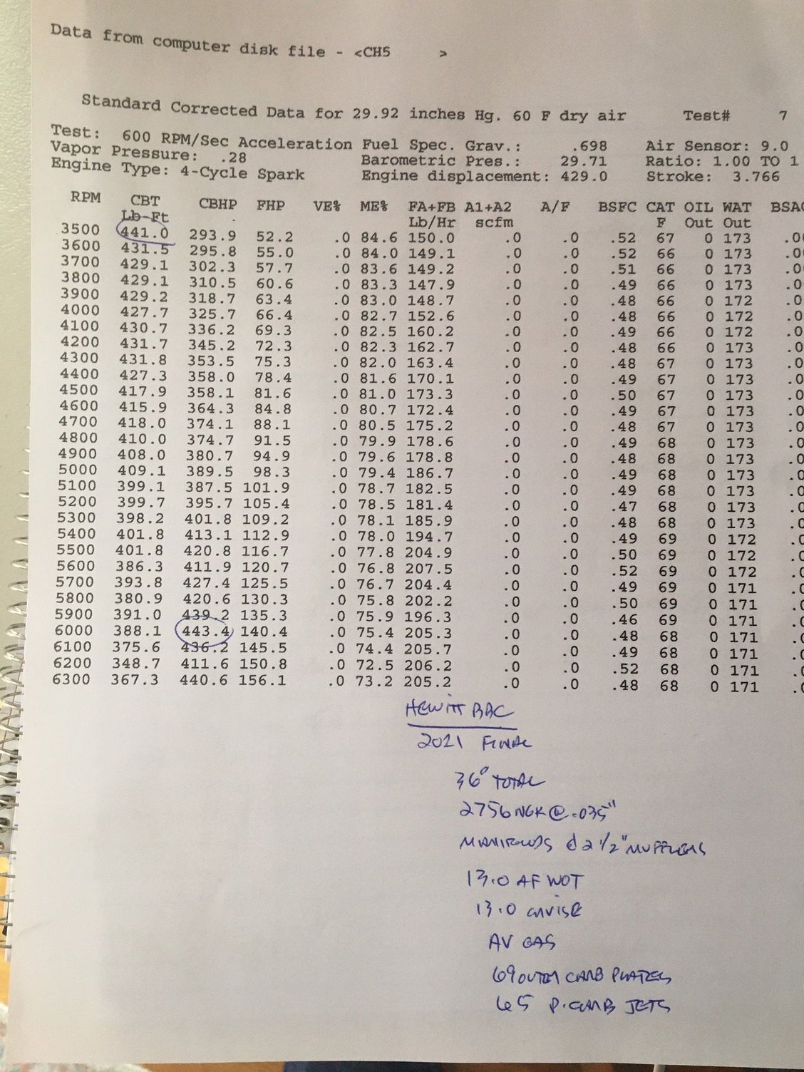

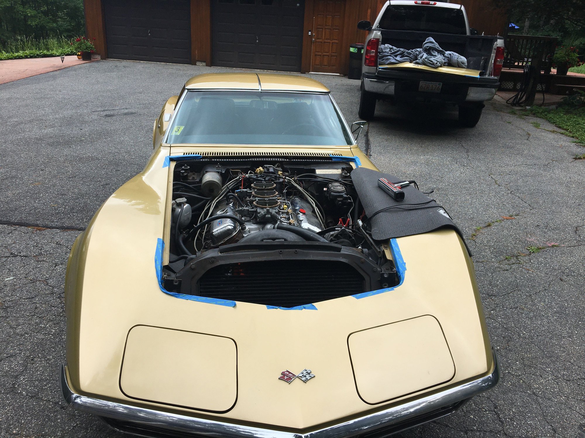

Well the motor is back in and I couldn't be happier. Crazy smooth power thorough 6000+ rpm and nice steady 750 rpm idle. Now I want to get all the available power by ditching the stock manifolds and 2-inch system with headers and a 2.5 or 3 inch system. I've purchased Hedder long tubes and am currently test fitting and will have them ceramic coated. So Im considering the following scenarios:
1) I was going to go with a Corvette Central welded 2.5 inch system but am not crazy about the 2.0 inch muffler exit. Does the 2 inch versus 2.5 exit matter?
2) Cobble together a 2.5 inch system from Summit or Jegs and have muffler shop fabricate the connection between header collector and pipe
3) Have muffler shop do it all. There is a local guy who does really nice custom stuff.
I want quiet idling / cruising but want power all the power available. All replies appreciated. Chris

Ok, just completed the dyno run. Custom Comp grind of 230/230 duration, 570/570 lift at 10.5 CR. 16 inches of vacuum at 850 rpm.
https://youtu.be/RO59_thUQ2s

Joe, yes hydraulic roller versus solid as modern hydraulic rollers can easily do 6500 rpm, and I’m done with the novelty of setting lash. Though I will miss the tick tick tick of the solids.
Went with a 112 LSA for C3 vacuum requirements and idle quality. It’s a 230/230, 570/570 custom Comp grind. If I had to do it again I’d probably go more lift and duration on the exhaust just on principle, as big Chevy exhaust is restricted compared to the intake. But no complaints and I can’t wait to get the new long tubes and 2.5 inch system on there.

Joe, yes, I did pocket port the heads but did not have them flow tested. Per Duke and others, I focused on cleaning up the casting flashing and smoothing \ flattening the radius(s) near the valve seats.
The stock L-71, like all Chevy cams of the era, were 110 LSA and I believe all the current crate ZZ motors still use 110 LSA. 110 is a good compromise (high rpm, low vacuum race motors 106,versus high torque, high vacuum low rpm motors 114+)
For comparison, specs for the ZZ427 hydraulic roller cam are 224/234 and 527/544 with 110 LSA.
The idle characteristics of the new cam are virtually identical to the original L-71 cam, nice and lopey at 750 rpm. The new cam definitely seems stronger everywhere. I don't if its because my old cam was dead or it's the characteristic of a roller cam.

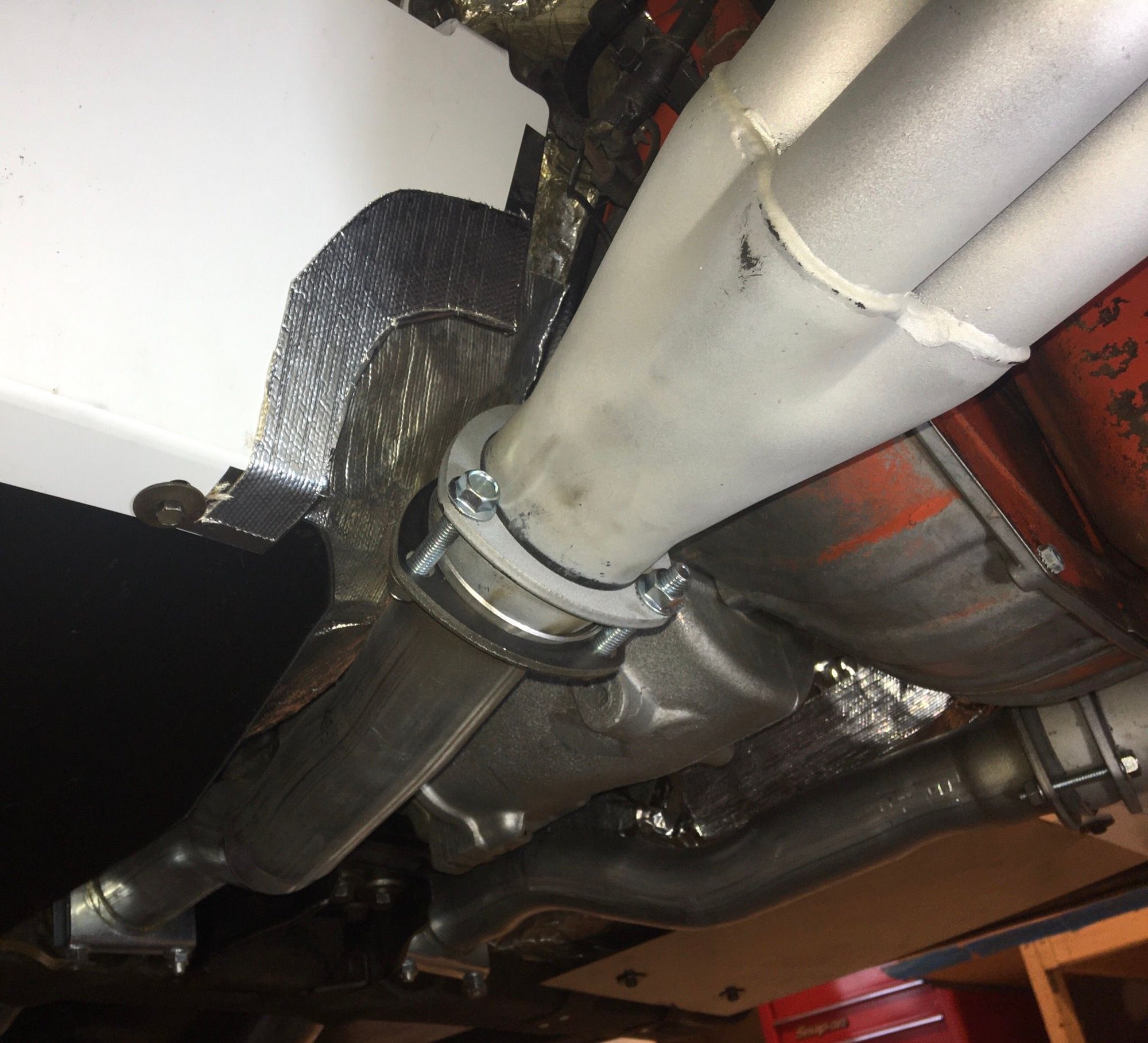

Ok, new 2.5 inch exhaust system including headers.
A few challenges along the way. The first was that the 2.5 inch pipe on the pass side would barely squeak through the hole in the frame cross member because of how low the exhaust hanger was. Turns out the original 50+ year old rubber trans mount had collapsed. So I got a new repro on on but the exhaust hanger was still cockeyed. Only thing that could cause that is something related to the engine mounts. Argh. My new repro engine mounts causing trouble. These are the '70 safety style I ordered from Corvette Central. I ordered Moroso solids but wanted to give the repros one more shot. So I loosened up the motor mounts and jacked up the pass side of the block until I heard creaking. Then I tightened the mounting blots and that seemed to do the trick. The exhaust hanger was now almost level.
Went with the Hedman long tubes, ceramic coated black by a local guy. I didn't like the black so I painted them silver with VHT primer, then color, then clear coat. I like the way they came out; subtle but noticeable, but not too much like the factory ceramic coating can be. I also used Eastwood ceramic spray paint for inside the headers too.

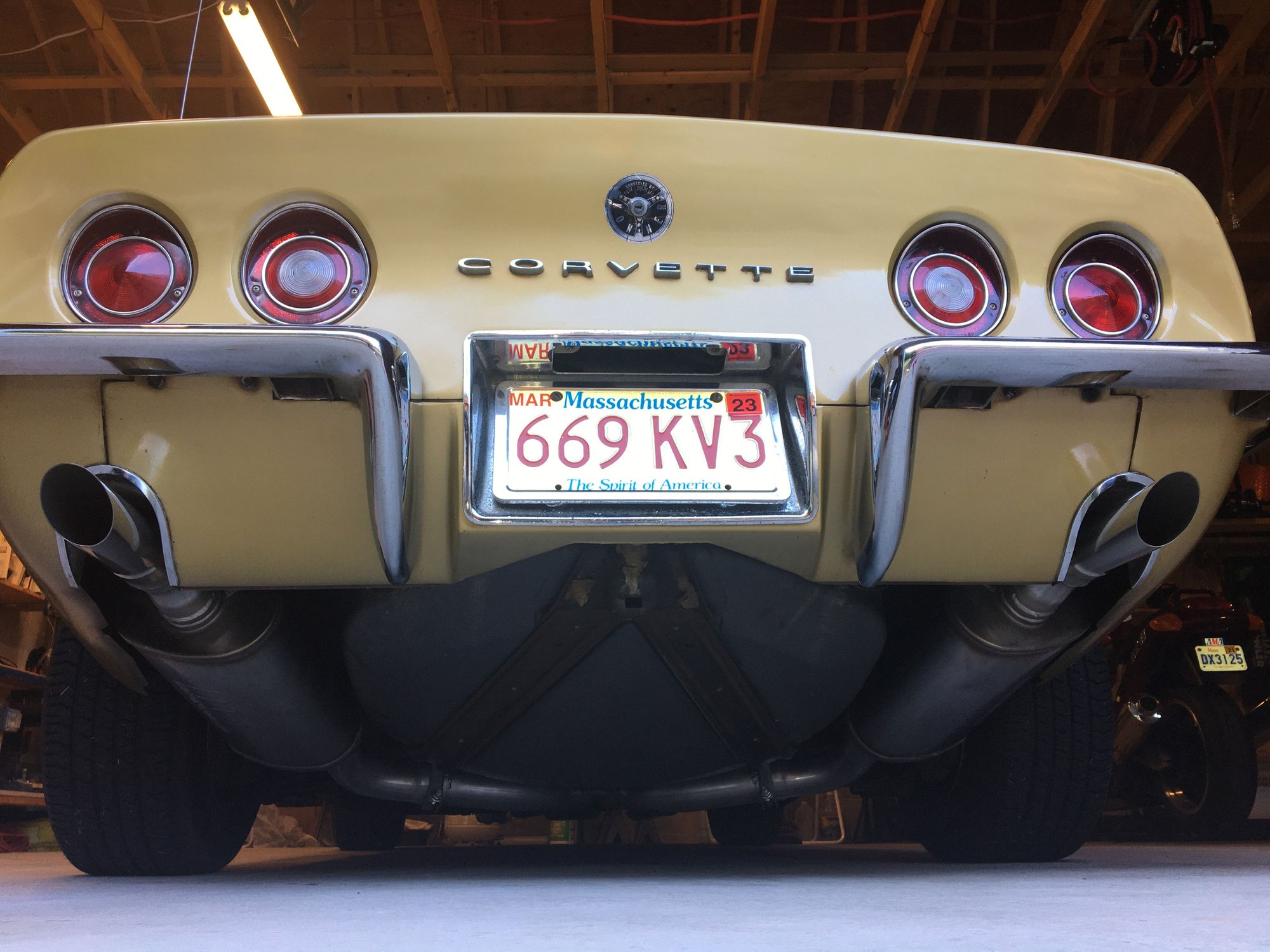

I had a local exhaust guy do the pipes from the header to the intermediate pipes supplied by Corvette Central. Those connect to MagnaFlows supplied by Corvette Central, and finally I used 2.5 inch Pypes tips.
I had exhaust guy cut off the 2 inch muffler outlets and weld on 2.5 tips, so its a true 2.5 system the whole length.
The MagnaFlows are nice and quiet, but get loud when stomped on. Even wife says nice and quiet.
The car is now so fast and visceral. Smokes tires at top of 2nd gear.
